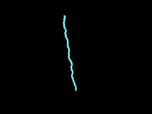

My first try at lightning.
I can't seem to get it to show on any other background though. I also still
need to figure out how to do the branches.
The code is posted to p.t.s
Comments and help welcome.
Nekar
Add absorbing media, with complement colour to the emitting media.
Ingo
From: Nekar Xenos
Subject: Re: Lightning WIP
Date: 28 Apr 2001 06:09:14
Message: <3aea96ca@news.povray.org>
I've got it working now.
Thanks
Nekar

Nekar Xenos <j-p### [at] citywalkcoza> wrote in message
news:3aea8c3a@news.povray.org...
still
Make it recursive.
#macro lightning(......)
 #if (ChanceToBranch < rand(rnd))
    lightning(.......)
 #end
#end
ChanceToBranch should decrease each time
it recurses so that the macro will finish at some time.
I've got some lightning code that I never finished. If you like
I'll post it.
Gail

I don't know about the rest, but I would like to see the code.

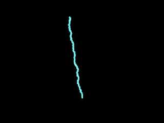

I while ago I wrote a macro for lightnings .. I'll see, if I can find it again ...
here is a pic I did with it ...
background{rgb 1}camera{location<1,5,-2>look_at 0}#macro m(a,b,i)#local d=(b-a)
/8;#local e=vcross(d,y);#if(i)m(a-e,a+e+2*d,i-1)m(a+e,a+2*d-e,i-1)m(a+3*d-e,a+e
+3*d,i-1)m(a+3*d-e,a+5*d-e,i-1)m(a+6*d-e,a+e+6*d,i-1)m(a+8*d-e,a+e+8*d,i-1)#else
cylinder{a,b,vlength(d)/3 pigment{rgb 0}}#end#end m(-4*x,2*x,4) // Jan Walzer
Download 'img1.png' (65 KB)
Preview of image 'img1.png'

Not exactly what I was looking for, but can you remember how you did the
branching? (This is more like sparks than lightning)
Nekar
