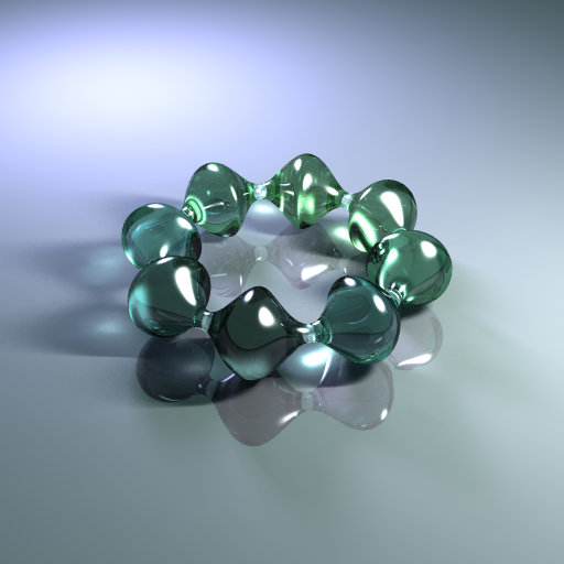

JRG <jrg### [at] hotmailcom> wrote:
: I have to say that I did know POV (I mean MegaPov) can make such images.
: That's the reason why I use Pov instead of Lightflow (which is much less
: flexible even if it has some interesting features).
  I wasn't actually answering to your question. I just was curious whether
I could make a similar image with povray or not, and decided to post the
results in the same thread.
: My question was about
: the render time of such features and not about quality. The Lightflow image
: I posted took just one minute or two to render (and, I have to repeat,
: everything but the shadows is raytraced). The same image made with MegaPov,
: which is posted here (I modified Warp's texture to make it more like the
: original), took more than 40 minutes to render with my Athlon 1Ghz
  This can't be true.
  The image I posted took 13 minutes to render in this Ultra5. The rendering
speed of this computer is aproximately the same as of a P-II 400MHz.
  An Athlon would have rendered it in less than 5 minutes.
  You have to also take into account that the version I posted uses an
isosurface while the lightflow version uses probably just a triangle mesh (or
does it?).
  If I had created a triangle mesh instead, it would have probably doubled
the rendering speed. (Perhaps I should test this.)
: (with an area light 10x10 and adaptive 1).
  Well, of course if we start to add unnecessary quality... Why not use
+a0 +am2 as well? And radiosity?
  Of course this way we can make it slower.
: To Warp only: I'll give you money if you manage to make the second image I
: posted with MegaPov (hope you will). Ah, render time was somewhere between 5
: and 6 minutes...
  I can try.

:   The image I posted took 13 minutes to render in this Ultra5.
  Reducing the accuracy of the isosurface to 10^-3 reduced the render
time to 8 minutes without any visible difference in the image.

I've had a good look at JRG's Lightflow image and Warp's POV version. If you
closely examine the shadows on each of the images, the deficits of the
Lightflow zbuffering technique become apparent - all the shadows are
blurred/softened equally. There are no sharp shadows where the object is
close to the plane which isn't as accurate as the POV shadows.
: and 6 minutes...
  Ok, this one was a bit tougher. I didn't even get a 99% match as in the
first case. This is more like a 80% match:
Download 'lftest2.jpg' (29 KB) Download 'lftest2b.jpg' (30 KB)
Preview of image 'lftest2.jpg'
Preview of image 'lftest2b.jpg'
If I didn't know better I would say these were photographs. Cool!
