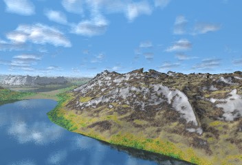

From: Bob H
Subject: Lake View, or: wow reflection blur + iso can be slow [~50K Jpg]
Date: 5 Apr 2001 08:30:59
Message: <3acc6583$1@news.povray.org>
normally until the last 20 lines or so.  It took a couple hours (or less) to
get to the part where the reflection of the nearby hillside shows up in the
water.  From there it was doing one line every few minutes and steadily got
slower.
I do very little with reflection_blur but I suspect that could be why, the
combination of it and isosurface.  No kidding, huh?
Some 4 hours to finish for this size, was hoping to get a much larger one
made quicker, once it's ready.  Not so sure now  :-)
Bob H.

From: Bob H
Subject: Re: Lake View, guess you'd like a look... [~34K Jpg]
Date: 5 Apr 2001 08:34:41
Message: <3acc6661@news.povray.org>
... so here it is this time, for what it's worth.

Subject: Re: Lake View, or: wow reflection blur + iso can be slow [~50K Jpg]
Date: 5 Apr 2001 09:05:57
Message: <3ACC6DB6.AA3DA529@gmx.de>
> slower.
That's fairly normal for isosurface & reflection, reflection blur even
more.  Usually in such a scene i would expect the horizon part to be quite
slow too.
Before the last 20 lines there is not much of the isosurface to be
reflected so things are probably quite fast.  I would estimate that the
mountain reflections in the lake are the part which is slowest.
Just add some radiosity and you will find everything before extremely fast
Nice scene BTW, the clouds look quite good, just the rim of the lake seems
a bit steep.
From: Geoff Wedig
Date: 5 Apr 2001 10:54:23
Message: <3acc871f@news.povray.org>
Bob H. <omn### [at] msncom> wrote:
> Main reason for posting this Bryce-like ?ender is to say that this went very
> slower.
Hmm, not certain why you're even bothering with an iso.  The distance and
wave size mean that a surface normal would probably be more than sufficient
for this image, even if blown up to a very large size.
Also, I wonder why you are using blurred reflection, since reflections on
water are pretty sharp.  If you want the blurring, then I'd think you'd want
rougher water, not blurred reflec.  So I guess I wonder why you're using
these features in this instance.
It's a very nice pic, all the same.
Geoff
From: Tom Melly
Date: 5 Apr 2001 11:19:41
Message: <3acc8d0d@news.povray.org>
"Bob H." <omn### [at] msncom> wrote in message
news:3acc6583$1@news.povray.org...
Which is the iso - the water, the landscape, or both (I'm assuming the
water)?
From: Bob H
Date: 5 Apr 2001 12:58:51
Message: <3acca44b@news.povray.org>
"Geoff Wedig" <wed### [at] darwinepbicwruedu> wrote in message
news:3acc871f@news.povray.org...
sufficient
Huh?  :-)  Oh!  You think the water is an isosurface!  Ha ha.  Well no, it
is not.
want
The blurring is taking place of mere normals or displacement (isosurface?).
Figured I'd give it a try for effect.  I have to change the amounts the
three water textures have I can tell because it doesn't have smooth and
rough areas like it had before.
Thanks, glad you liked it anyway.
Bob H.
From: Bob H
Date: 5 Apr 2001 12:59:41
Message: <3acca47d@news.povray.org>
I knew I should have said the water is only a textured plane.
Bob H.
"Tom Melly" <tom### [at] tomandlucouk> wrote in message
news:3acc8d0d@news.povray.org...
> water)?
From: Bob H
Date: 5 Apr 2001 13:05:44
Message: <3acca5e8$1@news.povray.org>
news:3ACC6DB6.AA3DA529@gmx.de...
> slow too.
Indeed it was.  Only the sky and midway down the lake was it what I'd call
"fast".
Correct.
> a bit steep.
Believe me, I thought about using radiosity before I realized how slow it
gets at the last lines.
And thanks, making a shoreline is one of the intended additions, if I can
get it right.  I think it hasn't any scale much until I do.
Bob H.
From: Geoff Wedig
Date: 5 Apr 2001 13:41:07
Message: <3accae33@news.povray.org>
> sufficient
> is not.
Ah!  I assumed that they were on the same object.  Oops.
> want
Ah, ok, experimenting.  Hmm.  Not sure what to suggest.
Geoff
From: Sander
Date: 5 Apr 2001 15:22:45
Message: <MPG.1536e46e9b21cd6c989730@NEWS.POVRAY.ORG>
In article <3acc6661@news.povray.org>, Bob H. says...
This is tantalizingly small, but I understand that you would be in
trouble if you rendered a larger one :)
Regards,  Sander
