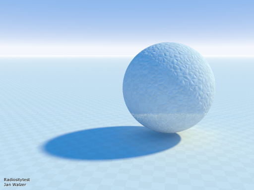

OK ...
I tried "normals on" and its so beatiful now ...
It took 'bout 2 hours with a crash between ...
So maybe the lower half is not correct with radio....
I can't see any artifacts, but I can't give my word ..
background{rgb 1}camera{location<1,5,-2>look_at 0}#macro
m(a,b,i)#local d=(b-a)
/8;#local
e=vcross(d,y);#if(i)m(a-e,a+e+2*d,i-1)m(a+e,a+2*d-e,i-1)m(a+3*d-e,a+e
+3*d,i-1)m(a+3*d-e,a+5*d-e,i-1)m(a+6*d-e,a+e+6*d,i-1)m(a+8*d-e,a+e+8*d
,i-1)#else
cylinder{a,b,vlength(d)/3 pigment{rgb 0}}#end#end m(-4*x,2*x,4) // Jan
Walzer
Download 'radiosity_test.png' (121 KB)
Preview of image 'radiosity_test.png'

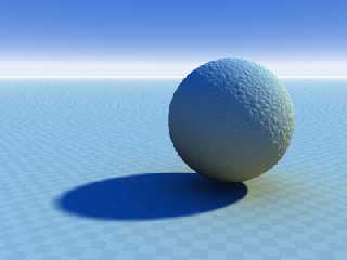

From: Tony[B]
Subject: Re: Radiosity2-Now with "ambient Normals"
Date: 20 Mar 2001 13:24:43
Message: <3ab7a06b@news.povray.org>
Here's my version, with my rad settings, a sky_sphere and a corrected sphere
texture.
Download 'janzrad.jpg' (18 KB)
Preview of image 'janzrad.jpg'

From: Jan Walzer
Date: 20 Mar 2001 14:21:06
Message: <3ab7ada2@news.povray.org>
Your settings are ?
... did you change the finish of the texture, or only the Rad-Settings
seems quite dark for me ... but so far .. thanx ..

From: Jan Walzer
Date: 20 Mar 2001 14:26:40
Message: <3ab7aef0@news.povray.org>
Hehe ... I asked this myself ...
The Heaven is blue ...
so the most ambient is blue ...
The sun is yellow ...
so where the sun hits the sphere, there is the ambient and the sun
(blue + yellow) that gives white ...
The shadow of the sphere, that is not lit by the sun is blue, because
of the ambient ...
below the sphere there is no ambient, but the sun brightens some parts
so it gets yellow ...
You understand ?

From: Tony[B]
Date: 20 Mar 2001 20:52:17
Message: <3ab80951@news.povray.org>
> Your settings are ?
global_settings
 assumed_gamma 1
 ini_option "+QR"
 radiosity
  pretrace_start 0.32 pretrace_end 0.08
  count 300 nearest_count 4
  error_bound 0.01 recursion_limit 1
  low_error_factor 0.5 gray_threshold 0
  minimum_reuse 0 brightness 1
  max_sample 1 adc_bailout 0.01/2 normal on
> texture, or only the Rad-Settings ?
I only changed the rad-settings and the pigment of the sphere.
That can be fixed by using a higher brightness or gray_threshold. I didn't
mean to imitate your settings, just show you that I had fixed "reflection"
the problem.

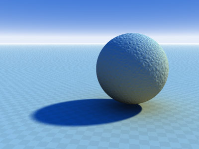

From: Kari Kivisalo
Date: 21 Mar 2001 05:33:31
Message: <3AB88380.89C707E7@kivisalo.net>
Ken wrote:
> No, I don't. I have never seen any situation in real life that this
> would represent.
How can you compare then?
I have seen several photometric images of physical setups and
corresponding rad simulations in IEEE and other publications
which clearly show the validity of radiosity. There are differences
in implementations, like noise in the ray based radiosity, but the
basic concept is solid.
The problem with all radiosity implementations is that there are too
many cryptic parameters to tweak so users in general use non optimal
setup which ruins the simulation. There is an EU project ARCADE which
tries to automate the parameter tweak phase among other things so that
you don't have to be "Certified Radiosity Technician" to produce good
results. http://www-imagis.imag.fr/ARCADE/
This particular scene is a poor choice for meaasuring how realistic
the simulation is for two reasons. The "sky" emits the same amount of
"energy" as the "sun". Nobody has ever seen this situation so it's a
bit difficult to compare. The scene is also uniform in all directions.
There is something funny going on with background{} and radiosity.
I rendered the same scene enclosed in a sphere and the anomaly at
the bottom of the sphere disappeared.
http://hammer.prohosting.com/~kkivisal/sphere.jpg
