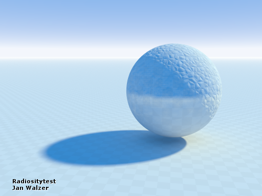

First: I've not that much experience with radiosity; maybe I'm just
using the wrong parameters...
I wanted to try something simple, when I saw the radiosity pic of
Tony[B]...
I've put a sphere on a checkered plane (hehe, typical POV), made a
blue background and  added a ground fog, to give it some depth.
The light is far away and is an area(9,9)light
Then I added +QR and waited (6hrs)...
There are 2 things, that I see...
I know that the algorithms work this way but it doesn't seem realistic
(How realistic is a single Sphere on a checkered plane?)..
the obvious thing is that the crackles aren't lit by the environment
by radiosity, but only by the sunlight ...
the second thing, (I'm not sure about this) is that there is this edge
on the sphere, that makes it seem, to be a mirror...
In the lower half the sphere is brighter, than the upper half. It's
from the radiosity, reflecting the groundfog-brightness ...
But I didn't expect such a sharp edge ... Maybe I'm wrong ...
except these things it looks quite beautiful .. (I'think)
Because it's short, I've attached the source here ...
Comments and hints are welcome...
You're not using the ones I use, at least. No one is quite sure which ones
are the "right" ones. It's mostly a guessing game. I've been using mine
quite happily for some time now. They were developed in conjunction with
Gilles and Xplo et al. Even then they need to be adjusted a bit on a
per-scene basis.
> I saw the radiosity pic of Tony[B]...
I inspired someone... <rapture> :)
One thing I wish could be added.
> is that there is this edge on the sphere,
I noticed this when I used count 1 or 2. I don't see why you're getting it
here.
In this unrealistic situation, I think it's correct.
Do radiosity ever look otherwise? :) I'll try your source with my parameters
later. I'm rendering a tabasco bottle for someone.
Subject: Re: Radiosity: Algorithm vs. Reality
Date: 20 Mar 2001 09:58:36
Message: <3AB7701E.FD765123@gmx.de>
- use 'normal on' in the radiosity block.
- it's always better to use real surface distortion (isosurface) instead
of normal.  Of course it's much slower.
Some things that should be changed:
- use finish { ambient 0 } for the sphere
- recursion_limit 3 is really unnecessary for such a simple scene.  1 or
maybe 2 is perfectly sufficient.  This also avoids the sharp blue/white
boundary.
I can't find information on this in the POV manual or the MegaPOV manual
(07)  When was this feature added?
On the other hand, it did help me find the "media on" feature, which might
help in my curren WIP scene (although probably will slow it down immensely)
Geoff

From: "Christoph Hormann" <chr### [at] gmxde>
environment
Where is this described ?? I've never read this ...
instead
It's obvios that this will work, but not necessary to give the thing a
little structure ...
edge
It's
It already has this from GroundTex ...
That's what I learned first: In Radiosity pics objects don't need
Ambient, or they will glow...
1 or
blue/white
> boundary.
I'd preferred to go even deeper ...
which ones
mine
with
> per-scene basis.
I used the guide in the radiosity chapter of the old docs ...
Of course, I know, Nathan has changed(rewritten?) the radiosity part,
but I hoped, the params still have the same function...
No ... not inspired ;)...
I just felt I also need some testing in Radiosity, cause everyone else
is doing this ...
Christoph told me something about the "normal on" parameter in the
radio-statement...
I'm rendering now ...
getting it
> here.
It's
parameters
Of course not ...
I hope it will be bigger than the last Image ... ;)

From: Spock
Date: 20 Mar 2001 11:08:09
Message: <3ab78069@news.povray.org>
I think a sphere on a plane always ends up with a sharp line because of the
underlying geometry.  Your sphere has a brighter than average division line
because of the cumulative effect of all that fog (looking at your horizon I
can see a whiter-than-white stripe that gets reflected in your sphere).
I know nothing about radiosity and look forward to seeing your experiment
evolve.
Date: 20 Mar 2001 11:17:37
Message: <3AB782A2.465737A9@gmx.de>
Oops, i missed that, sorry.
