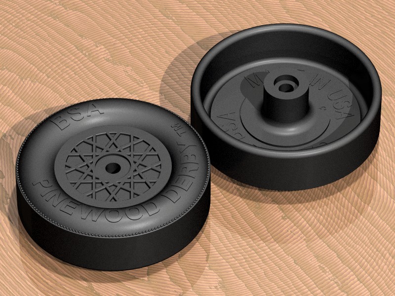

My younger son's Cub Scout Pinewood Derby is coming up and I thought it
would be fun to model the car before we build it.  So far I've done the
wheel and have started on the axle.  The image below was modeled in Moray
3.3, uses MegaPov 0.6, antialiasing, radiousity (I think), and reflection.
It took about 4hrs 15min to render on a AMD Athlon 1.2Ghz.  DUDE!  Isn't
that an unrealistically long time for an image like this?  It has ALOT of
CSG, but the render time surprised me.  I've heard bounding mentioned here
before but don't really have a good understanding of how to use it.  Anyone
have any suggestions about how to decrease the render time, or about
improvements on the wheel?  Does MegaPov need a command line switch to
actually turn on radiousity?
Thanks,
Cris Williams

It's not that astonishing IMO, since you are using several light sources,
reflection, complex objects, ...
Maybe try turning off those things one after the other and check the
render time.
BTW, the wood texture looks a bit strange with the concentric rings
(normal?)
Yes, you have to add '+qr' to turn it on in addition to the radiosity{}
block.

The wood textured plane is just something I picked at random to slide under
the wheels at this point.  But your right, I could have picked a less
distracting texture.  Another question about radiousity - since I'm using
Moray, the Pov code doesn't have the "#version unofficial MegaPOV 0.6;" line
in it.  Will the radiousity be Pov-style or MegaPov-style without it?  At
this point I'm not using any MegaPov-specific features (but I do want
MegaPov radiosity).

Subject: Re: Pinewood Derby Phase I (143 KB)
Date: 22 Feb 2001 09:43:47
Message: <3A9525A0.5B2D79D8@gmx.de>
> MegaPov radiosity).
Megapov docu, section: Enabling MegaPov Features:
"Backwards compatibility is not available for radiosity."
meaning that it always uses megapov radiosity.
Anyway using old style radiosity settings will not give any reasonable
results so you will probably not be able to avoid editing the files
manually.

I can't help you to explain the long render time, but I think the
texture is great! Will you publish it??
Regards,  Sander
From: Cris Williams
Date: 22 Feb 2001 10:50:49
Message: <3a953559@news.povray.org>
It's nothin' fancy, but thanks!
#declare wheel_texture =
   material  // wheel_texture
      texture
         pigment
            color rgb <0.239567, 0.239567, 0.1979>
         normal
            bumps , 0.05
            bump_size 0.05
         finish
            ambient 0.0
            diffuse 0.1007
            brilliance 3.909667
            phong 0.165467
            phong_size 30.463333
            specular 0.194233
            roughness 0.3308
            reflection 0.0275
            crand 0.0935
Cris Williams

*DEFINATLY* look at using some isosurface boards using the Isowood
include.  Make things VERY nice, even if just for background stuffs..
>          finish
>             ambient 0.0
>             diffuse 0.1007
>             brilliance 3.909667
>             phong 0.165467
>             specular 0.194233
>             roughness 0.3308
>             reflection 0.0275
>             crand 0.0935
There usually is not much need to use both phong and specular highlights
apart from slowing things down and creating certain special effects.
From: Bob H
Date: 22 Feb 2001 12:25:35
Message: <3a954b8f$1@news.povray.org>
news:3A9### [at] gmxde...
> >             phong 0.165467
> >             specular 0.194233
> >             roughness 0.3308
Ah yes, but in this case it does make a difference.  Seeing this message I
at first thought the roughness was 0.03308, not 0.3308.  If it were then
both highlights would have been very similar in both intensity and size.
This texture actually has a relatively large specular and smaller phong
highlight.
I often use the both of them together.  Anyway, I figure you might have also
thought the two were close in appearance so I wanted to speak up here.
Bob H.
