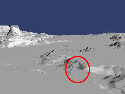

For reference, here is the code and I've attached a more pathological
example:
#include "colors.inc"
  camera{
    location <-.7, 1, -7>
    look_at 0
    angle 45
light_source{ <1000,1000,-1000> White 1.5 }
background {color <0.2,0.25,0.42>}
height_field
  png  "devils_tower_WY.png"
  smooth
  translate <-.5, 0, -.5>
  scale <15,1,15>
  pigment { White }
I've highlighted one of the areas with a red circle just to be clear (though
I don't believe it's not visible).  As you can see the terrain is properly
rendered except for these odd quad patches that have, what appears to be, an
incorrect normal.  Around it, though, are finely detailed hill slopes that
are fine in all respects.  What I don't it is... if I'm doing something
wrong here, why isn't it uniformly wrong?
Thanks for helping with this everyone. :)

Ken Tyler
Subject: Re: Help, Height Field visual error?
Date: 9 Feb 2001 03:14:38
Message: <3A83A6EF.C607E86A@gmx.de>
David Whatley wrote:
> Oh, and here is the source image in case it is helpful for reproducing the
> problem.
The problem is your heightfield file, don't know how you generated it, but
it contains 'lower lines' between the different seperated levels of height
(see attachment)
I tried to apply a smoothing filter to weaken that effect but you should
better use a geographically correct heightfield.
Download 'image1.png' (7 KB)
Preview of image 'image1.png'
