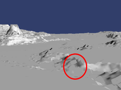

I'm sorry, my limited experience with POV must be showing.  I was under the
impression that there were normals on the resulting mesh.  If not, it would
not generate any of it accurate, right?   What would the syntax be for
adding a normal?
For reference, here is the code and I've attached a more pathological
example:
#include "colors.inc"
  camera{
    location <-.7, 1, -7>
    look_at 0
    angle 45
light_source{ <1000,1000,-1000> White 1.5 }
background {color <0.2,0.25,0.42>}
height_field
  png  "devils_tower_WY.png"
  smooth
  translate <-.5, 0, -.5>
  scale <15,1,15>
  pigment { White }
I've highlighted one of the areas with a red circle just to be clear (though
I don't believe it's not visible).  As you can see the terrain is properly
rendered except for these odd quad patches that have, what appears to be, an
incorrect normal.  Around it, though, are finely detailed hill slopes that
are fine in all respects.  What I don't it is... if I'm doing something
wrong here, why isn't it uniformly wrong?
Thanks for helping with this everyone. :)
David Whatley
dw### [at] playnet

From: Ken
Subject: Re: Help, Height Field visual error?
Date: 9 Feb 2001 03:02:13
Message: <3A83A3F0.F17334D7@pacbell.net>
David Whatley wrote:
> "Mick Hazelgrove" <mic### [at] mhazelgrovefsnetcouk> wrote in message
> news:3a839924@news.povray.org...
> > Hi
> > I have found that in addition to Ken's suggestion, adding a normal will
> > solve the problem.
> > Mick
> adding a normal?
> example:
Adding a normal is easy to add and gives you a lot of options to work
with. Any pattern that works as a pigment also works within a normal
statement. I tested this example with the .png you sent me and it
effectively removed the problem you were seeing (although I did go
a bit overboard with it - YMMV).
See below for a simple example -
 height_field
   smooth
  scale <15,1,15>
   pigment { White }
     normal { granite 1 scale .5 }
Ken Tyler
Date: 9 Feb 2001 03:14:38
Message: <3A83A6EF.C607E86A@gmx.de>
> Oh, and here is the source image in case it is helpful for reproducing the
> problem.
The problem is your heightfield file, don't know how you generated it, but
it contains 'lower lines' between the different seperated levels of height
(see attachment)
I tried to apply a smoothing filter to weaken that effect but you should
better use a geographically correct heightfield.
Download 'image1.png' (7 KB)
