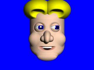

I've started playing with POV to generate blob heads and have come across a
problem.
The main portion of the head is a cylinder component scaled down in Y and
matrixed to give the jaw line an upward tilt.
The problem is where the chin meets the main part of the head.  There is a
line and a difference in texture between the chin and the rest of the head.
I have posted the code in povray.text.scene-files
I have moved the lights around (At first I thought it was a shadow).
Is the problem with the scaling and /or matrix transformation of the main
cylinder component ?
Download 'head.jpg' (8 KB)
Preview of image 'head.jpg'

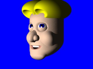

Here is the head yet again from a different angle and different lighting.
The problem is even more aparent now.
Again, the whole file (.pov) posted to p.b.s-f (just so I don't clip out
some of the variable declarations).

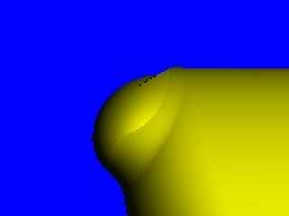

The matrix operation is your problem.  Without it, the demarcation in pigment
disappears.
It looks like pigments, matrices, and blobs don't work well together.    Don't
know if this is a bug or what...
Simplified version of your code below, zooming in on the chin at an angle:
#include "colors.inc"
background{Blue}
camera{location<0,1,-10> look_at<-.6,0.4,0> angle 4 }
light_source{<5,5,-20> color White*1.5}
#declare head=
        blob{   threshold .35
                cylinder{<0,-.5,0><0,1,0>,.55,10
                        scale<1,.6,1>
                        //COMMENT OUT THIS LINE TO SEE SMOOTH PIGMENT//
                        matrix< 1, 0, 0, 0, 1, 0, 0,.4, 1, 0, 0, 0>
                        //YES, THAT LINE ABOVE THIS ONE!
                sphere{<0,0,0>.3, 2 scale<1.2,.6,.5> rotate x*-45
translate<0,-.6,-.35>}
                texture{pigment{Yellow}}
object{head rotate <90,90,0>}
Download 'lavoiechin.jpg' (3 KB)
Preview of image 'lavoiechin.jpg'
