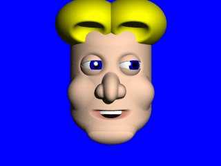

I've started playing with POV to generate blob heads and have come across a
problem.
The main portion of the head is a cylinder component scaled down in Y and
matrixed to give the jaw line an upward tilt.
The problem is where the chin meets the main part of the head.  There is a
line and a difference in texture between the chin and the rest of the head.
I have posted the code in povray.text.scene-files
I have moved the lights around (At first I thought it was a shadow).
Is the problem with the scaling and /or matrix transformation of the main
cylinder component ?
Download 'head.jpg' (8 KB)
Preview of image 'head.jpg'

I see a lighter shade of color on the lower front of that chin but not very
distinguishable from the usual diffuse highlighting I'd expect to see there.
Can you render a closer look with the lighting different, i.e. from an even
more pronounced angle?  Right now it just seems to be the flattened end of that
cylinder to me.  Also, the connecting lines are difficult to smooth out in my
experience, tending to be present even at low thresholds.
Bob H.

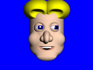

Here is the head yet again from a different angle and different lighting.
The problem is even more aparent now.
Again, the whole file (.pov) posted to p.b.s-f (just so I don't clip out
some of the variable declarations).

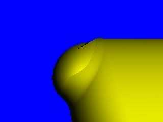

The matrix operation is your problem.  Without it, the demarcation in pigment
disappears.
It looks like pigments, matrices, and blobs don't work well together.    Don't
know if this is a bug or what...
Simplified version of your code below, zooming in on the chin at an angle:
#include "colors.inc"
background{Blue}
camera{location<0,1,-10> look_at<-.6,0.4,0> angle 4 }
light_source{<5,5,-20> color White*1.5}
#declare head=
        blob{   threshold .35
                cylinder{<0,-.5,0><0,1,0>,.55,10
                        scale<1,.6,1>
                        //COMMENT OUT THIS LINE TO SEE SMOOTH PIGMENT//
                        matrix< 1, 0, 0, 0, 1, 0, 0,.4, 1, 0, 0, 0>
                        //YES, THAT LINE ABOVE THIS ONE!
                sphere{<0,0,0>.3, 2 scale<1.2,.6,.5> rotate x*-45
translate<0,-.6,-.35>}
                texture{pigment{Yellow}}
object{head rotate <90,90,0>}
Download 'lavoiechin.jpg' (3 KB)
Preview of image 'lavoiechin.jpg'

The painstaking answer is to blob lots of little things together............

To shear without using a matrix, rotate, scale non-uniformly, and
rotate back in position.
