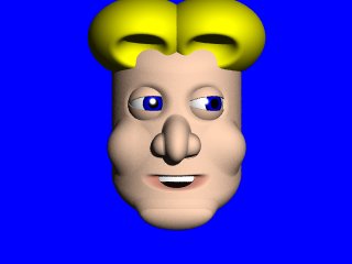

I've started playing with POV to generate blob heads and have come across a
problem.
The main portion of the head is a cylinder component scaled down in Y and
matrixed to give the jaw line an upward tilt.
The problem is where the chin meets the main part of the head.  There is a
line and a difference in texture between the chin and the rest of the head.
I have posted the code in povray.text.scene-files
I have moved the lights around (At first I thought it was a shadow).
Is the problem with the scaling and /or matrix transformation of the main
cylinder component ?
Download 'head.jpg' (8 KB)
Preview of image 'head.jpg'
From: Bob H
Subject: Re: Help. Problem with Blob Head
Date: 8 Feb 2001 04:52:23
Message: <3a826c57@news.povray.org>
Hi Marc.  Your binary file needs to go into the povray.binaries.scene-files
group instead of the povray.text.scene-files one.  If you could do that and
cancel the other
it would be in keeping then with guidelines here.
povray.announce.frequently-asked-questions has info on what's expected.
[ I cancelled this reply twice already because I keep forgetting to say that
you could post just the text into the message body there at p.t.s-f. instead of
the "binary" pov file.  Would make for easier viewing for people to help you.
Plus, if at all possible, using the smallest amount of a pov script to show the
problem is recommended to be posted at povray.general or newusers {adnvanced
group too if topical for there}.  However, I don't think people will mind your
scene file in whole either. ]
I see a lighter shade of color on the lower front of that chin but not very
distinguishable from the usual diffuse highlighting I'd expect to see there.
Can you render a closer look with the lighting different, i.e. from an even
more pronounced angle?  Right now it just seems to be the flattened end of that
cylinder to me.  Also, the connecting lines are difficult to smooth out in my
experience, tending to be present even at low thresholds.
Bob H.
From: Greg M  Johnson
Date: 8 Feb 2001 08:07:00
Message: <3A82988D.DE526780@my-dejanews.com>
My guess is that it's not really a difference in texture but a ridge in the
surface which is the correct (albeit undesired by you) mathematical result of
the blob components you put in there.   That's just my guess.  You said you
moved lights around: try rotating figure around......

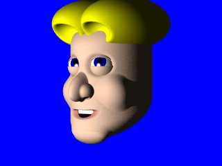

Here is the head yet again from a different angle and different lighting.
The problem is even more aparent now.
Date: 8 Feb 2001 11:52:29
Message: <3A82CD5D.E0681695@my-dejanews.com>

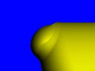

The matrix operation is your problem.  Without it, the demarcation in pigment
disappears.
It looks like pigments, matrices, and blobs don't work well together.    Don't
know if this is a bug or what...
Simplified version of your code below, zooming in on the chin at an angle:
#include "colors.inc"
background{Blue}
camera{location<0,1,-10> look_at<-.6,0.4,0> angle 4 }
light_source{<5,5,-20> color White*1.5}
#declare head=
        blob{   threshold .35
                cylinder{<0,-.5,0><0,1,0>,.55,10
                        scale<1,.6,1>
                        //COMMENT OUT THIS LINE TO SEE SMOOTH PIGMENT//
                        matrix< 1, 0, 0, 0, 1, 0, 0,.4, 1, 0, 0, 0>
                        //YES, THAT LINE ABOVE THIS ONE!
                sphere{<0,0,0>.3, 2 scale<1.2,.6,.5> rotate x*-45
translate<0,-.6,-.35>}
                texture{pigment{Yellow}}
object{head rotate <90,90,0>}
Download 'lavoiechin.jpg' (3 KB)
Preview of image 'lavoiechin.jpg'
From: Marc A  Lavoie
Date: 8 Feb 2001 13:11:44
Message: <3a82e160@news.povray.org>
Thanks Everyone.  I sort of figured it had something to do with the matrix.
Any ideas on how I could fix this and still get the slant in the jaw?
Date: 8 Feb 2001 13:18:27
Message: <3A82E197.E753EF5D@my-dejanews.com>
The painstaking answer is to blob lots of little things together............

From: Peter Popov
Date: 11 Feb 2001 15:54:58
Message: <40l98tod3cp5orva52gtmfnu8uaqbhjv0s@4ax.com>
On Thu, 8 Feb 2001 13:14:10 -0500, "Marc A. Lavoie"
To shear without using a matrix, rotate, scale non-uniformly, and
rotate back in position.
Peter Popov ICQ : 15002700
