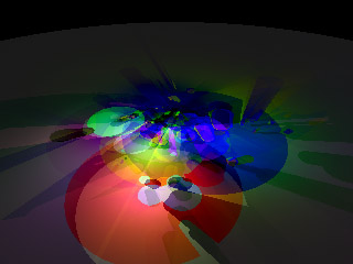

From: Ben Lauritzen
Subject: Pretty (~23KBU)
Date: 20 Jan 2001 12:02:50
Message: <3a69c4ba@news.povray.org>
Just playing.
#version unofficial MegaPov 0.6;
camera {location 100 look_at 0}
$seed1=seed(1305987);
$A=0;
#while (A < 30)
  $A=A+1;
  light_source {
    <100*rand(seed1)-50,100*rand(seed1),100*rand(seed1)-50>,
    <2*rand(seed1)-1,2*rand(seed1)-1,2*rand(seed1)-1>
    spotlight
    point_at <100*rand(seed1)-50,-100*rand(seed1),100*rand(seed1)-50>
    radius 90*rand(seed1)
    falloff 90*rand(seed1)}
  cylinder {
    $pos1=<100*rand(seed1)-50,30*rand(seed1),100*rand(seed1)-50>;
    pos1,
    <pos1.x,pos1.y+40*rand(seed1),pos1.z>,
    5*rand(seed1)
    pigment{rgb<2*rand(seed1)-1,2*rand(seed1)-1,2*rand(seed1)-1>}
    no_image
#end
cylinder{0,y*-1,300 pigment{rgb 1}}
Download 'test.jpg' (24 KB)
Preview of image 'test.jpg'
From: Chris Huff
Subject: Re: Pretty (~23KBU)
Date: 20 Jan 2001 15:01:48
Message: <chrishuff-A34529.15025520012001@news.povray.org>
In article <3a69c4ba@news.povray.org>, "Ben Lauritzen"
<loo### [at] yahoocom> wrote:
> Just playing.
Hmm, I wonder what this would look like if you put it inside a plain
white sphere with double_illuminate...
Christopher James Huff

From: Ben Lauritzen
Date: 21 Jan 2001 22:31:37
Message: <3a6ba999@news.povray.org>
Quite ugly actually, but that's my opinion.
