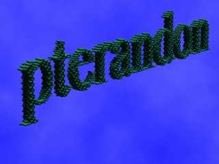

See file in p.b.s.-f.
Code fills with spheres in fcc structure.
Download 'volume31.jpg' (16 KB)
Preview of image 'volume31.jpg'

ian mcdonald wrote:
> I never got it to work. I never came close. I don't even know where to start
> beyond needing an intersection testing algorhythm.
You don't need that. The object function does the trick, plus knowing how the
face centered cubic structure is stacked...
Here is the core of my algo:
   #declare obfun=pigment {object {MyObject color Black color White}}
                #local dd=array[5]
                #local drr=(2^0.5)*radii;
                #local dd[1]=<0,0,0>;
                #local dd[2]=<0,drr,drr>;
                #local dd[3]=<drr,0,drr>;
                #local dd[4]=<drr,drr,0>;
    #local place=dd[nnnn]+<minx+ix*dx,miny+iy*dy,minz+iz*dz>;
    #local blank=eval_pigment(obfun,place);
    #if (blank.x>0)
               sphere {place,radii*1}
    #end

From: Chris Huff
Subject: Re: Fill any object with dense-packed spheres of any radius (16kbbu)
Date: 31 Dec 2000 11:05:25
Message: <chrishuff-33756A.11064931122000@news.povray.org>
In article <3A4F4A4A.3FB3A8E2@videotron.ca>, Francois Labreque
<fla### [at] videotronca> wrote:
> From what I understand, it is someway of making sure the inside of your
> object is white, and the outside, black.  Am I right?
He is using the object pattern in MegaPOV as an interior testing method,
the first thing following the object covers all points outside the
object, the second covers all interior points. So you are correct, it is
a pigment that is a white shape surrounded by black in the shape of the
object.
Christopher James Huff
From: Chris Huff
Date: 31 Dec 2000 11:20:55
Message: <chrishuff-CF1915.11222031122000@news.povray.org>
In article <3a4f3e21@news.povray.org>, "Greg M. Johnson"
Hmm, I use something more like "eval_pattern(object {MyObject})" when I
do this...actually, I wrap it in a macro.
This would make your code shorter and probably slightly reduce parse
time(though the use of a macro might counteract that benefit), the main
advantage is that it is shorter and easier to read.
Instead of:
    #if (blank.x>0)
My version would be:
#macro InObj(Pt, Obj) eval_pattern(object {Obj}, Pt) #end
    #if(InObj(place, MyObject))
