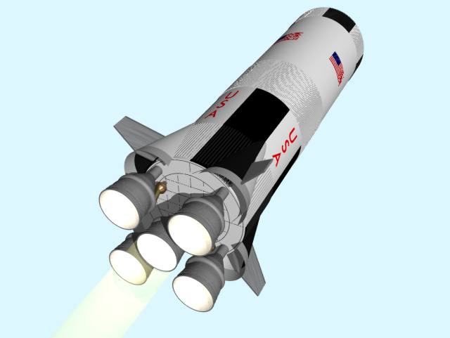

Here is the first stage of a Saturn V I am modeling. I want to get the flame
better than this, but I am not familiar with media. What it needs to be
essentially is a cylinder about 600 feet long and about 12 feet in diameter
that is at the core very hot and white-yellow, but fades to transparent at
the outer radius, then also fades to zero radius at the 600 foot "tail" end.
Somebody must have done this already. Any suggestions?
Jon
Assuming 1 POV unit per foot:
difference{
           sphere{<0,0,0>,12
                  scale <1,1200,1>
           cylinder{<0,0,0>,<0,600.1,0>, 12.1}
          // Texture/Media stuff goes here.
          } // End of difference.
I think that Bob H did one of these (or something similar):
http://users.aol.com/persistenceofv/all.htm
 12:32am  up 11:52,  2 users,  load average: 1.00, 1.00, 1.00

I can get the CSG object stuff easily. It's the "Texture/Media stuff" that
is new to me - actually just the media stuff. Playing in Moray helps out.
It's a nice image, but the markings and dimensions of the rocket are off. I
am being very precise on measurements and markings and other details.
Jon

You noticed... :-)  I actually never used dimensions based on actual numbers, I
measured a poster-sized photograph I have and followed what looked about right.
It should be fairly close though.
'media' is not very user friendly, everyone knows that.  I had trouble putting
5 media objects together because overlaps would mix in odd ways.
Something like this should be a start anyhow:
camera {location -15*z
        look_at 0
background {rgb .5}
#declare T0=density {rgb 0}
#declare T1=density {wrinkles frequency 1
                     turbulence <1,3,1>*1
                           density_map {
                                [0 rgb <.1,.5,1.25>*0]
                                [.25 rgb <.667,.5,.3667>*.125]
                                [.5 rgb <1,.75,.5>*.5]
                                [.75 rgb <.75,.5,.367>*.25]
                                [1 rgb <1,.8,.5>*.75]
                  } scallop_wave scale .4 }
#declare T2=density {wrinkles frequency 1
                     turbulence <1,3,1>*2
                           density_map {
                                [.25 rgb <.667,.5,.3667>*.25]
                                [.5 rgb <1,.75,.5>*.75]
                                [.75 rgb <.75,.5,.367>*1.25]
                                [1 rgb <1,.8,.5>*1.5]
                  } scallop_wave scale .2 }
sphere { 0, 1  hollow // no_shadow
 pigment { color rgbf 1 }
 interior {
        media { method 2
                intervals 1 samples 2,2
                emission <.9,.75,.5>*.75
                absorption <.25,.33,.5>*.5
                 scattering {4,<.6,.3,.1>*.5 extinction .5}
                  density {cylindrical frequency 1
                     turbulence <1,3,1>*.2
                           density_map {
                                [0 T0]
                                [.5 T1]
                                [.67 T2]
                                [.75 T1]
                                [1 T2]
                  } ramp_wave scale .99 }
                  translate -50*clock*y // motion
       // fade_distance 4 fade_power 1
   scale <1,4,1> // scale change needs inverse density change
(requires MegaPov, as is)
Nice Saturn booster btw.
numbers, I
right.
Nobody but a space nerd would notice ;-)
FYI, a lot of good information can be gleaned from www.apollosaturn.com. I
took a truckload of pictures of the Saturn V lying on it's side here at
Johnson Space Center last week, and I am using those photos, as well.
putting
I'll take a stab at it. Anyone aware of a media tutorial?
Thanks. I hope I can find time to finish it.
Jon
