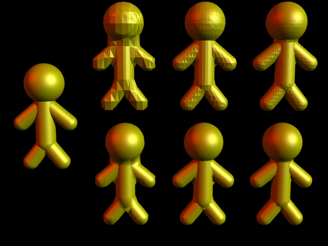

I have been working on a tesselation patch for POV-Ray. My intention is also
to make a mesh data extraction patch (else the tesselation patch would be
pretty useless).
  You can tesselate any object with a finite bounding box with it. The
syntax is:
tesselate(Object, Accuracy, Smooth, BBox_Offset)
with the last two parameters being optional.
  The first parameter is the object to be tesselated (must have a finite
bounding box).
  The second object is an accuracy value. Must be a positive integer value.
  The third parameter is a boolean value which tells the function whether
to calculate flat or smooth triangles.
  I'll explain the fourth parameter when the patch is more ready.
  The function returns a regular mesh object which can be used anywhere a
mesh object can be used.
  With the other patch you will also be able to extract the data
(vertices, triangles, normals...) from the mesh (from any mesh, not just
the ones created with the tesselation function).
  This is an example of the very first working version of the patch (that
is, it doesn't crash ;) ).
  Code and image:
#default { pigment { rgb <1,1,0> } finish { specular .5 } }
#declare Obj =
  union
  { sphere { y,.5 }
    cylinder { y,-y*.5,.25 }
    sphere { -y*.5,.25 }
    cylinder { y*.5, -x*.6, .2 }
    sphere { -x*.6, .2 }
    cylinder { y*.5, x*.6, .2 }
    sphere { x*.6, .2 }
    cylinder { -y*.5, -x*.4-y, .2 }
    sphere { -x*.4-y, .2 }
    cylinder { -y*.5, x*.4-y, .2 }
    sphere { x*.4-y, .2 }
object { Obj translate -x*3 }
object { tesselate(Obj, 10) translate -x+y*1.5}
object { tesselate(Obj, 10, yes) translate -x-y*1.5}
object { tesselate(Obj, 20) translate x+y*1.5}
object { tesselate(Obj, 20, yes) translate x-y*1.5}
object { tesselate(Obj, 30) translate x*3+y*1.5}
object { tesselate(Obj, 30, yes) translate x*3-y*1.5}
camera { location <0,2,-13> look_at 0 angle 35 }
light_source { <200,100,-150>, 1 }
light_source { <-200,100,-100>, x*.5 }
Download 'tesselationtest1.jpg' (85 KB)
Preview of image 'tesselationtest1.jpg'

Forgot to mention rendering time:
Time For Parse:    0 hours  0 minutes  14.0 seconds (14 seconds)
Time For Trace:    0 hours  1 minutes  17.0 seconds (77 seconds)
    Total Time:    0 hours  1 minutes  31.0 seconds (91 seconds)

There are some artifacts with tesselated object ('body' and 'arm' are
connected), would it be easy to avoid this? Or does bigger accuracy
helps in this case?
Will cracks be problem with this tesselation?

That sounds very promising, Does it work on isosurfaces? It would be very
useful for speeding up things in some cases.
When do you think we can expect the first release?

  It should work with any object with a finite bounding box.
  I haven't tested it with isosurfaces, but I don't see any reason why it
shouldn't work with them as well.

  I would also like to study if the tesselation algorithm could be
improved. Right now it doesn't work quite well with sharp edges.
