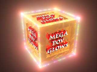

Hi,
I just wrote my first macro, and although it's probably incredibly simple to
most of you, I'm still quite pleased.
The macro simply places a number of glows equally spaced between two points.
It would be improved if the glowstring could be made 'slack', so that it
dropped in the middle as though affected by gravity, but I have absolutely
no idea how to do something like that.
Anyway, I've posted my little macro in p.t.s.f, called GlowSting Macro. If
anyone wants to improve it, I'd be interested in seeing what changes you
make. For example, is there a better way of doing it than using a #while()
loop?
Ok, here's a pic I made using the macro:
Download 'GlowString.jpg' (27 KB)
Preview of image 'GlowString.jpg'

Andy Cocker wrote:
Looks...bright :) Thats hurting my eyes
> points. It would be improved if the glowstring could be made 'slack', so
> that it dropped in the middle as though affected by gravity, but I have
> absolutely no idea how to do something like that.
Take a look at the MakeTree macro - it allows the tree to be "pushed" and
"pulled" by a gravity vector. It looks like what you want is a severly
compressed quadratic (1/200x^2), let x run bewteen one end, to zero, then
to the other end. The equation will then produce the right y coordinate.
You could get fancy, define a zero point and all too (+ a second
compression ratio for the other end ;)) (that would be useful in
animations, a rippling whip or rope).
Anyway, enough of this :)
Looks great!
Yann
