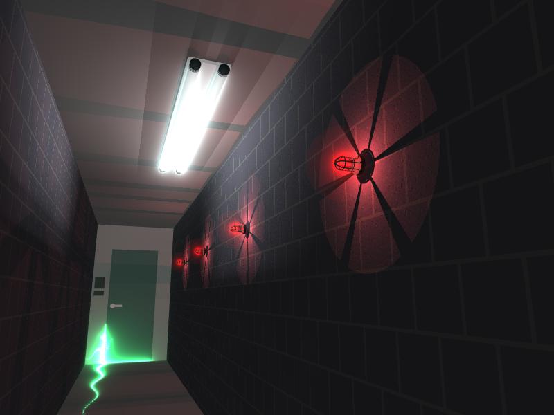

Since I didn't come near finishing this for the latest round, I thought I
would post it here anyway. Far from finished, I only had a few uninterrupted
hours to work on it and spent most of that getting the nearly invisible
tendrils that creep out from the door jam.

From: Andy Cocker
Subject: Re: Escape from Lab #608
Date: 25 Nov 2000 12:44:56
Message: <3a1ffa98@news.povray.org>
The red lights end abruptly, and it really needs for the green tendril glow
to light up the corridor...radiosity? This has definite potential.

From: Bill DeWitt
Date: 25 Nov 2000 19:30:14
Message: <3a205996$1@news.povray.org>
    That is the shadow of a ring on the lamp cage.
    That's next, but it think I will use lights.
    Plus I need a thousand details. Like the rest of the door and the Brick
Wall macro... This is what may never get done, I can't seem to do that kind
of work unless I have hours at a stretch. Usually I have only a few minutes
at a time. I have that often during the day, but rarely a whole hour at
once.

From: Thomas Lake
Date: 25 Nov 2000 19:48:00
Message: <3A205D65.C6759793@home.com>
I agree with Andy though, even if it is a shadow it doesn't help the realism
any. I think it would be better if you had the lights fade out instead of end
in a shard circle. Perhaps increase the falloff rate, or make them into area
lights.
From: Bill DeWitt
Date: 25 Nov 2000 21:00:56
Message: <3a206ed8@news.povray.org>
"Thomas Lake" <tla### [at] homecom> wrote in message
news:3A205D65.C6759793@home.com...
realism
end
area
> lights.
    Well I agree too. Maybe it will be as simple as moving the ring up a
small amount.

From: Remco de Korte
Date: 26 Nov 2000 06:18:33
Message: <3A20F173.B4E8D9C@onwijs.com>
Thomas Lake wrote:
> lights.
The problem may also be that the lights here are pointlights.

From: Bob H
Date: 26 Nov 2000 06:22:50
Message: <3a20f28a$1@news.povray.org>
Imaginative... Kind of a Outer Limits type thing I thought.
No one mentioned the fluorescent light sharp shadows.  Area lights all around would be
the answer I'd think.
From: Bill DeWitt
Date: 26 Nov 2000 08:08:16
Message: <3a210b40@news.povray.org>
around would be the answer I'd think.
    I tried that. Maybe there is a way to get area lights to light up a
bigger area? It made the FL. fixture cast light only on one point of the
ceiling and walls. I ended up with a line of lights all the way down the
fluorescent tubes. I tried giving them a little random xy movement but that
just made banding. Maybe I should try both point lights and area lights, but
that still might make a very bright point in the center of the fixture.
    I also tried area lights in the emergency lights. Until I got very small
ones I couldn't get the grain out of the shadows. Then the line came back.
Maybe the cage should be shadowless?
    I did try radiosity. I would have to start over and I don't think glows
work very well, or at least how I expect them to work, with radiosity. Maybe
I will try again.

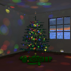

From: Bob H
Subject: Re: Escape from Lab #608 [added rad example ~31K Jpg]
Date: 26 Nov 2000 10:23:33
Message: <3a212af5@news.povray.org>
Or maybe wait until there are true "area" area lights?  Long wished for, never has
happened yet... that I know
of.
Know what you mean by radiosity and glows.  Take a look at this ugly beauty I attached
here.  It ain't workin'!
Note I labeled it "betterrad", well you ought to have seen the worse one.
Download 'xmastree betterrad.jpg' (24 KB)
Preview of image 'xmastree betterrad.jpg'
From: Chris Huff
Date: 27 Nov 2000 21:34:47
Message: <chrishuff-11AF8F.21352027112000@news.povray.org>
In article <3a212af5@news.povray.org>, "Bob H."
<per### [at] aolcom?subject=PoV-News:%20&body=Relating%20to%20POV-Ra
> for, never has happened yet... that I know of.
Depends on what you mean...you can use an object with a high ambient
texture to do it, or you can use a grid of light_sources. If you mean
having area lights be calculated for all illumination instead of just
shadows, that would probably be nearly as slow as using a grid of many
individual lights, though a bit easier on the memory. It isn't a bad
idea, just hasn't ever really been needed...
> beauty I attached here.  It ain't workin'!
"Ugly beauty"...
Well, this is probably happening because glows can get extremely bright
toward the center...sometimes radiosity will send out a sample that
happens to make a near miss, and the extreme brightness throws off the
radiosity calculation, making a "splotch". I have been thinking of a
"max_brightness" keyword to fix this...
Christopher James Huff
