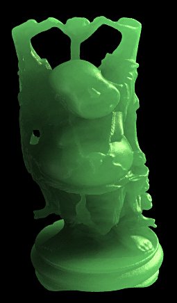

From: Mael
Subject: sss buddha [16kb]
Date: 27 Nov 2003 12:57:07
Message: <3fc63af3@news.povray.org>
Cool effect ! I had to try it on the happy buddha :)
M
Download 'sss_buddha.jpg' (17 KB)
Preview of image 'sss_buddha.jpg'
From: ABX
Subject: Re: sss buddha [16kb]
Date: 27 Nov 2003 13:04:09
Message: <pvecsvs12t4nbochfjelltaa0qpcvbjq7b@4ax.com>
Indeed, there is no end of fun in good old POV-Ray ;-)
ABX
From: Samuel Benge
Date: 27 Nov 2003 13:40:14
Message: <3FC6450C.1040709@hotmail.com>
This is the mlPOV technique, yes? Whatever you did, it looks really
good! That buddha statue was just itching to be rendered this way!
> M
Samuel Benge
stb### [at] hotmailcom
See my website@: http://www.goldrush.com/~abenge/Top/index.html
From: ts
Date: 27 Nov 2003 23:20:01
Message: <web.3fc6cbc7e7c0a33498a934b40@news.povray.org>
>M
indeed.
my first thought was that this could be used to simulate
a translucent jade.
this is way beyond me so i have a couple of questions ...
am i to understand that this particular method of samual's
requires mlpov? i haven't been able to run it with ver 3.5.
and ...
i have been trying to obtain this 'happy buddha'
file but see that it is in "lv" and some other format.
how is it possible to convert these to POV?
or is there somewhere i can find them converted ...
to what ... 'mesh' ?
tia for any leads and help.
ts
From: Samuel Benge
Date: 28 Nov 2003 00:22:51
Message: <3FC6DBA6.4020906@hotmail.com>
> and ... <break>
There are currently two versions of this technique I have posted to the
newsgroups. The official 3.5 version is in povray.binaries.scenes-files.
The mlPOV version is the one residing in the body of text at the
beginning of this thread.
Samuel Benge
