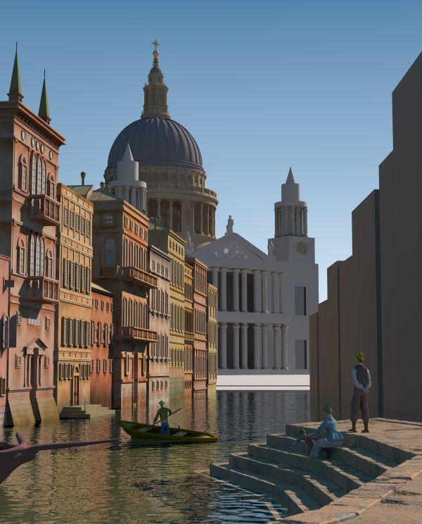

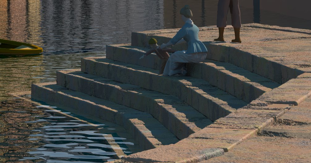

I have worked on the stairs - i'm not yet content with the colors, need to
be more saturated, but i thought i'd post the first version.
The geometry is changeable quite easily, feel free to experiment with the
control points and the sizes.  I'm not quite sure about the scaling, the
stairs are steeper in the original but they would be completely in shadow
then.  I am also not sure about the scaling.  I originally thought we have
1 unit = 1 meter but it seems more 1 unit = 2 meter.
Once we have agreed on a geometry the figures need to be adapted to it.  I
only placed them roughly for the moment.
It looks great even right now!
You are right about colors. Maybe it should not be so... colorful :)
Such detailed cathedral and this stair will need more details on houses.
So we will definitely will need heightfields or isosurfaces for basements :)
Gena.
From: Peter Hertel
Subject: Re: Capriccio - stairs (73+135k)
Date: 5 May 2003 14:59:35
Message: <3eb6b497@news.povray.org>
Breathtaking!
It's especially the dents that makes it look so good.
How many steps are the stairs going below the water? Is it supposed to
be only one, or is the water to dark to see the rest?

Peter Hertel wrote:
> Breathtaking!
What do you mean with 'dents'?
There is only one.  I am not sure how many it should be, the water is
probably not that deep directly at the steps.

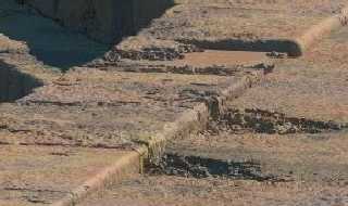

'Dents' as opposed to 'bumps'? Or did I miss the correct word
completely? See the attatchment.
-Peter
