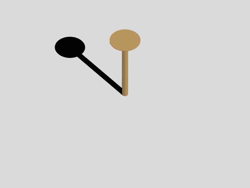

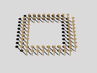

High!
Back at my co-processor project... meanwhile, I got all parts together,
but when placing the complete processor on a
horizontal plane for the first time, I discovered a strange bug: though
all pins are placed at the correct vertical position (i. e.
touching the plane), their shadows don't originate at their bases!
When I instead render only one single pin, this strange artifact
disappears, as you can see in the second image! I modelled the
processor from the real thing, using a slide caliper, so 1 unit = 1
meter - these pins are only 3.7 millimeters high and a mere
0.15 millimeters thick. Could it be that their tiny size is responsible
for the bug?
See you in Khyberspace!
Yadgar
Download 'pin_array.jpg' (50 KB) Download 'pin_single.jpg' (9 KB)
Preview of image 'pin_array.jpg'
Preview of image 'pin_single.jpg'

This came up in Beta testing, and it was determined that it's not a bug
http://news.povray.org/3c53b38e@news.povray.org
I believe that the workround is that if you're working with objects that
have dimensions of fractions of millimetres, then choose a smaller size
for the POV unit. (Or use a computer with a higher floating point
accuracy).
Mike Williams
