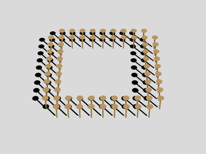

High!
Back at my co-processor project... meanwhile, I got all parts together,
but when placing the complete processor on a
horizontal plane for the first time, I discovered a strange bug: though
all pins are placed at the correct vertical position (i. e.
touching the plane), their shadows don't originate at their bases!
When I instead render only one single pin, this strange artifact
disappears, as you can see in the second image! I modelled the
processor from the real thing, using a slide caliper, so 1 unit = 1
meter - these pins are only 3.7 millimeters high and a mere
0.15 millimeters thick. Could it be that their tiny size is responsible
for the bug?
See you in Khyberspace!
Yadgar

This came up in Beta testing, and it was determined that it's not a bug
http://news.povray.org/3c53b38e@news.povray.org
I believe that the workround is that if you're working with objects that
have dimensions of fractions of millimetres, then choose a smaller size
for the POV unit. (Or use a computer with a higher floating point
accuracy).
