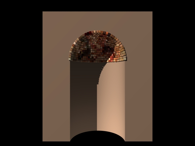

Fiddled about a bit more with tiles last night
and came up with this work-in-progress.
Aaron

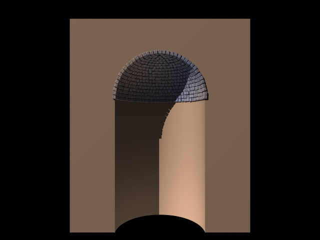

And here is one that samples a bitmap for the pigment
pattern.  It's not as successful as the previous one,
since the tiles are too large at present to make the
image in the mosaic discernable.
Aaron

Thats pretty amazing Aaron, how do you get tiles to line an arbitrary
surface like that? And with a pattern no less?
George

It's a bit complicated to explain, and my code is so
terrible that I don't dare post it.  Briefly, I thought
of the problem as lining the interior of a dome with
rows of tiles.  So, I used trigonometry to calculate
the X and Y position of one endpoint of each row and
then rotated the tiles around the Y axis.  The number of
tiles in each row was calculated by taking the
circumference of the circle defined by the end points
and dividing it by the size of the tile.  I then
rotated each tile to the proper angle.  Seems like
a lot of work for just this effect and I wonder if
there is not an easier way ...
