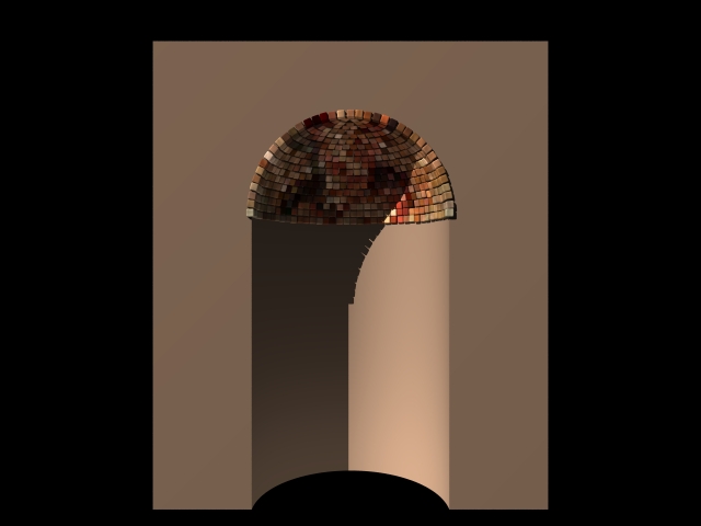

Folks:
Fiddled about a bit more with tiles last night
and came up with this work-in-progress.
Aaron
Aaron Gillies
New York City
xerxes[^]yahoo.com
Download 'success.jpg' (44 KB)

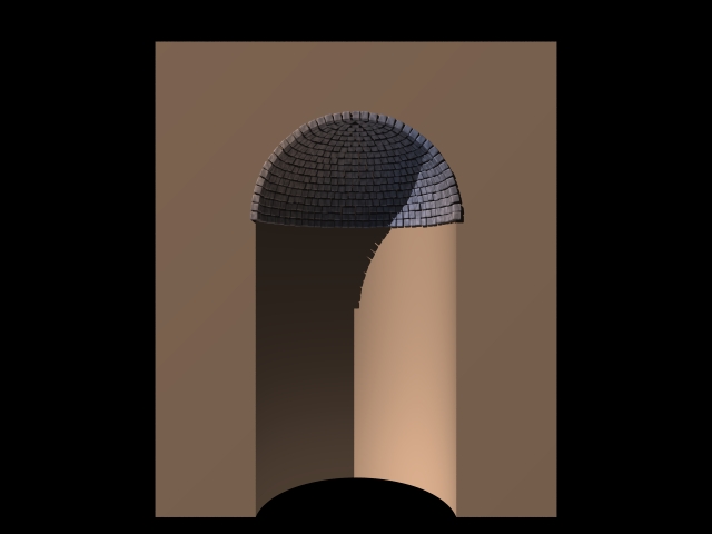

And here is one that samples a bitmap for the pigment
pattern.  It's not as successful as the previous one,
since the tiles are too large at present to make the
image in the mosaic discernable.
Aaron
Aaron Gillies
New York City
x3rxes[&]yahoo.com
Download 'success.jpg' (47 KB)
Preview of image 'success.jpg'
From: George Pantazopoulos
Subject: Re: More Fun with Mosaics (WIP)
Date: 6 Jan 2003 12:21:08
Message: <3e19bb04$1@news.povray.org>
Thats pretty amazing Aaron, how do you get tiles to line an arbitrary
surface like that? And with a pattern no less?
George
"Aaron Gillies" <no### [at] spamcom> wrote in message
news:3E1### [at] spamcom...
> Folks:
> Aaron
> Aaron Gillies
> New York City
> xerxes[^]yahoo.com
From: Aaron Gillies
Date: 6 Jan 2003 12:33:23
Message: <3E19BDE6.4090508@spam.com>
It's a bit complicated to explain, and my code is so
terrible that I don't dare post it.  Briefly, I thought
of the problem as lining the interior of a dome with
rows of tiles.  So, I used trigonometry to calculate
the X and Y position of one endpoint of each row and
then rotated the tiles around the Y axis.  The number of
tiles in each row was calculated by taking the
circumference of the circle defined by the end points
and dividing it by the size of the tile.  I then
rotated each tile to the proper angle.  Seems like
a lot of work for just this effect and I wonder if
there is not an easier way ...
Date: 6 Jan 2003 13:14:13
Message: <3e19c775@news.povray.org>
Hey Aaron,
    What if you used the spherical coordinates ( rho, phi, theta ) in a
nested loop? Theta is the angle corresponding to the floor of the dome. Phi
is the other angle, a *quarter-circle* going from the tip of the ceiling to
the
floor. It shouldnt matter if you increment phi or theta in your inner loop,
you'd just use the remaining one as the outer loop and increment it there.
    Theta would go from [0 to 2PI] and phi would go from [0 to PI/2], and
rho would be a constant (the radius of the dome). You would use a timestep t
and place a tile at every timestep in your inner loop (as well as increment
the angles). To actually place the tile, you would convert from spherical to
rectangular coords as follows:
x = rho sin (phi) cos ( theta )
y = rho sin (phi) sin ( theta )
z = rho cos (phi)
Just an idea, this would elegantly accomplish what you did in a loop.. I
just took Calculus 3, and this is basically how we integrate a multivariable
function in spherical coordinates.

From: Gilles Tran
Date: 6 Jan 2003 13:44:40
Message: <3e19ce98@news.povray.org>
It's more or less the same technique as the one used here
http://www.oyonale.com/ldc/images/arene.jpg
Took me a while to figure it out though. The main problem is that one can't
prevent bricks or tiles to be perfectly aligned one above each other once in
a while, which doesn't make sense in architecture... It's not a problem for
mosaics of course and with the proper mosaic texturing the results are
indeed nice.
G.

From: John Smith
Date: 6 Jan 2003 13:53:34
Message: <3e19d0ae$1@news.povray.org>
> z = rho cos (phi)
multivariable
That won't work to accomplish a good enough equidistant distribution. To see
why, consider the case where phi=0. You'll get stacked tiles at x=y=0, and
not enough tiles, say, at phi=Pi/2.
