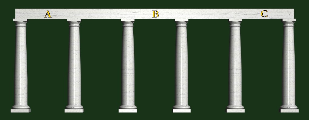

I am trying to model a column of the Tuscan order after the drawings in
"The First Book of Andrea Palladio's Architecture". The base and top is
easy enough, being simple geometrical shapes, but the shaft of the
column is another matter. It should not be a simple cone, but have some
swelling along the way up, to counteract some optical effect.
The method Palladio uses to get the shape, is to make the lower third of
the shaft perpendicular, and then place "the edge of a thin rule" along
that line and bend it back to the "point of diminution" at the top of
the shaft.
Since I can't find anything in the PovRay docs about using "thin rulers"
to odel things, I have tried to fake..eh..approximate the shape with
some different CSG primitives. I have come up with three variations, but
I'm having problems deciding, which one looks best, so I thought I'd ask
your opinions.
In the attached image the two colums on the left is one solution
(designated A), the tow in the middle another (B), and the two on the
right a third (C). Now just tell me which version you think looks best,
most "classical", most pleasing to the eye, or what you want to call it.
TIA
/Ib
Download 'tuscan3.jpg' (47 KB)
Preview of image 'tuscan3.jpg'
From: Philippe Debar
Subject: Re: Your opinions, please
Date: 31 Dec 2002 06:36:12
Message: <3e11812c$1@news.povray.org>
I like A the best, but it may be because of the lighting which is not
uniform from collumn to collumn.
BTW, I should have an corinthien collumn from the Books of Palladio's
somewhere, although the shaft is made of cylinders and cones. (I beleive I
was using pov 2.x at the time).

From: Hugo Asm
Date: 31 Dec 2002 08:14:37
Message: <3e11983d$1@news.povray.org>
It's difficult for me to see the difference. But I prefer the C shape,
because it looks stronger. I think A looks weaker, and B is confusing. Maybe
all 3 of them will do equally well, to hold up a building, but I just feel
most comfortable with C.
Hugo
From: Aaron Gillies
Date: 31 Dec 2002 10:25:17
Message: <3E11B6DF.5060305@spam.com>
Ib:
I like B best.  It seems somehow sturdier.
Aaron
From: Remco de Korte
Date: 31 Dec 2002 11:23:12
Message: <3E11C45B.7C393DD9@onwijs.com>
Ib Rasmussen wrote:
I think B is the best, closest to what it should be, but it
still looks a teeny bit exaggerated (even though it's more
subtle then the others).
Remco
Date: 31 Dec 2002 14:21:33
Message: <slrnb13rb1.ugk.steve@zeropps.org.uk>
B
sphere{z*5,1pigment{rgb.5}finish{reflection.3specular.5}}box{<-50,-3,-50>
<50,-2,50>pigment{checker/*\__\\__/  * \_\\__*/scale 2}finish{ambient.7}}
light_source/*__\\__\\__\\__\\__\(    ~ )\__\\__\\__\\__\\*/{<2,5,1>*4,1}
/*\\__\\__\\__\\__\\__\\__\\__\\__\~  -/__\\__\\__\\__\\__\\*//* Steve */

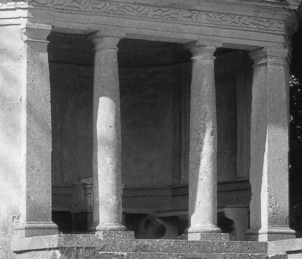

From: Daniel Matthews
Date: 31 Dec 2002 18:00:30
Message: <1478008.RZtzEWuvnK@3-e.net>
I think the attached image is from a Paladio Original.
N.B. there is some variation between free standing and the columns set
against walls etc. Your's look a little on the slim side.
Download 'tuscan_1.jpg' (26 KB)
Preview of image 'tuscan_1.jpg'
