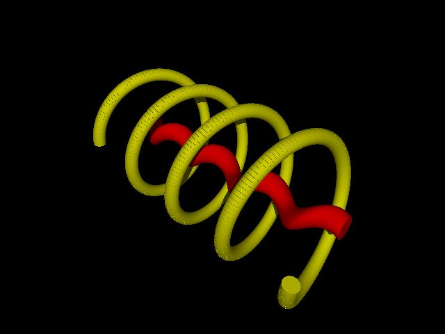

Hi,
  I was wondering if any of you knew how to make the following red
isosurface into something that look more like the yellow cylinder CSG?
ie. scaling the sinusoidal shape of the isosurface, but keeping the
small radius it has.
Here's my code for the iso:
#declare a = 100;
#declare b = 25;
isosurface {
  function { a*x*x + a*y*y  + b*x*cos(z*2*pi) + b*y*sin(z*2*pi) }
Thanks,
  Simon
Download 'iso-ifs.png' (47 KB)
Preview of image 'iso-ifs.png'
I assume you want to have a coil. Here is mine:
#macro pre_coil (l,r2,r1,steepness)
  #local rmax=(r1)+(r2);
  #local dmax=rmax*sqrt(2);
  #local omeg=(steepness)/(r2);
  #local pre_plane_stretch=1/(1+omeg*omeg);
  #local plane_stretch=sqrt(pre_plane_stretch);
  #local sqrsum=function(a,b) {a*a+b*b}
  #local sqrsum_=function(a,b,c) {a*a+b*b+c*c}
  #local coil_aux1=function(a_,b,c)
    {atanf(c*cos(a_)+b*sin(a_),b*cos(a_)-c*sin(a_))}
  #local coil_aux2=function(r,phi) {sqrsum(r-(r2),plane_stretch*r*phi)}
  isosurface {
    function {coil_aux2(sqrt(sqrsum(y,z)),coil_aux1(omeg*x,y,z))}
    contained_by {box {<0,-rmax,-rmax> <l,rmax,rmax>}}
    threshold (r1)*(r1)
    max_gradient 2*max(r2,sqrt(sqrsum_(
      (dmax-(r2)+pi*pi*pre_plane_stretch*dmax),
      (pi*pre_plane_stretch*dmax)
      (pi*omeg*pre_plane_stretch*dmax*dmax))))
    all_intersections
#end
is wraps around the line from <0,0,0> to <l,0,0>.
r1 and r2 are like the small and large radius of a torus.
steepness is the ratio of swirling to moving:
0 gives a straight cylinder, 1 gives an angle of 45 degrees,
-1 also, but in the other direction.
The usual screw will have positive steepness.
Comments welcome.
  Mark

From: Simon Lemieux
Subject: Re: Thightening an iso?
Date: 16 Dec 2002 17:18:03
Message: <3DFE51DC.E3C8F1B@no_spam.com>
Geez...  Maybe you could explain to me how to modify my isosurface.
My problem is that I don't actually want a coil, I want much more, but
as a start, a coil would be fine!
Is it possible to have my isosurface make a "round" shape on the z axis
between (-x), (x), (-y) and (y), given a sinusoidal function that I
would define myself like this:
#macro myFunc(xy, z)
  #if(xy == 0)
    d*cos(z)
  #else
    d*sin(z)
  #end
#end
(not sure if syntax is alright, but that's what my function would
basically look like)
Thanks Mark,
  Simon

From: Simon Lemieux
Date: 17 Dec 2002 20:20:02
Message: <3DFFCE01.FA9D64CB@no_spam.com>
> I still do not quite understand, what you want.
I'm sorry if I don't explain myself correctly...
> I assume at least that it could be described by
> some 2-dimensional shape that is rotated around
> the z-axis as it moves along the same.
That's it...
> In that
> case you need to describe the 2D shape by some
> 2D isosurface (isoperimeter, that is). Lets say
> that is described by f(x,y)=c. Then the 3D-shape
> is described by
>   f(x*cos(w*z)+y*sin(w*z),y*cos(w*z)-x*sin(w*z))=c
> which gives an isosurface all right. Now what I
> need to know is: What is your 2D-shape? In your
> scene it is defined by
>   a*(x^2+y^2)+b*x=c
> or, equivalently,
>   (x+b/2a)^2+y^2=c/a+(b/2a)^2
> Now this is a circle with center (-b/2a,0) and
> radius sqrt(c/a+(b/2a)^2). Maybe you would be
> more happy with an ellipse? To define one with
> radii rx in x-direction, ry in y-direction and
> center (cx,cy) take
>   f(x,y)=((x-cx)/rx)^2+((y-cy)/ry)^2
> and threshold 1. I do not know the scale in your
> scene, but maybe you would like to try
>   w=1/3, cx=2, cy=0, rx=3, ry=1
The circle is the shape I'm looking for, probably an elipse would make a
better result but it would have to rotate onto its center to make the
scene look right.  The circle is good!
So grabbing what you showed me, I guess this might give the results I'm
looking for...
#declare R = 0.1;
#declare Circle = function { pow(((x)/R),2)+pow(((y)/R), 2) }
isosurface {
  function { Circle(x*cos(w*z)+y*sin(w*z),y*cos(w*z)-x*sin(w*z)) }
Though, this gives me error in MegaPov, so I wasn't able to see the
results, I believe I missed something somewhere. It tells me that
instead of the first pow in the Circle function, it was looking for a
float factor.  What should I do?
Thanks,
  Simon
