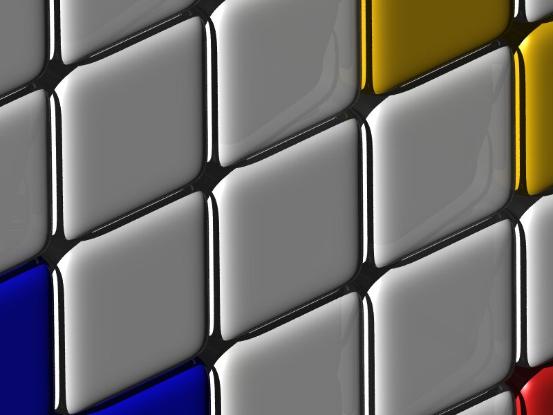

Hi Tracers!
There I'm again... in the meanwhile, I tried a different ornament
loosely gleaned from a Persian miniature, but when I rendered
a close-up view, I noticed a strange appearance of the superellipsoid
edges facing the light source. Firstly, I thought of
coincident surfaces (which in fact only could be true for the edge rows
of the total cube, as there are each rendered twice
because of somewhat inaccurate programming), but after an even closer
look (attached here) it became clear that it must be a
strange shadow anomaly.
The small superellipsoids use specular highlights and are also slightly
reflective; the shadow of each superellipsoid should be
solid, not only an outline... it appears almost as I had accidentally
produced some kind of caustics - but there is nothing
transparent!

Looks like more than just a shadow problem. What is the size of them? Very
small?

Looks like a precision problem to me. Just for checks, can you try
using an isosurface superellipsoid?

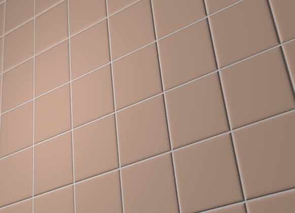

I devised a "perfect" tile from the superellipsoid a while back- here is the
code snippet:
#declare Ceramic = difference {
  superellipsoid {<2,.08> pigment {Tan}}
  box{<-1,-1,-.9>,1.1 pigment {Tan}}
  rotate 45*z scale 0.710
  finish {specular 1 phong 1 reflection .3}
  normal {dents frequency 3 scale <.3,.3,1>}
(end of code snippet)
    Here is how the finished tiles look- note the precise geometry.  Add your
grout as needed, change the color as you wish.
Cheers!
Chip Shults

Not REALLY small... in this scene, I used a matrix of 85 by 85 tiles, so each
tile is scaled to 1/85...

Hard to say at the moment - would using isosurfaces instead not take
forever?

Actually, an isosurface superellipsoid could be faster, it happens in
some cases. You could also use one isosurface for all the tiles, though
texturing would be fun...
