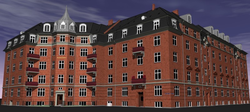

Message: <3DA0B9DC.50507@ibras.dk>
Another background building for my church model.
/Ib
Download 'bygning1.jpg' (91 KB)
Preview of image 'bygning1.jpg'
From: Rafal 'Raf256' Maj
Subject: Re: Another building
Date: 6 Oct 2002 19:27:25
Message: <Xns92A0E8D4609Fraf256com@204.213.191.226>
Ib Rasmussen <ib### [at] ibrasdk> wrote in news:3DA### [at] ibrasdk
nice :) I suggest to use not-so-contrast texutre, as it produce strong
morey (mini-waves on wall on right side of picture) or to use stronger AA
(especialy with much lower threshold, and maybe with jitter)
From: Ib Rasmussen
Date: 7 Oct 2002 02:02:55
Message: <3DA12387.1080802@ibras.dk>
Rafal 'Raf256' Maj wrote:
> nice :)
Thank you.
setting are aa0.01 +r6. There was a bit of discussion about it, when I
posted the previous building, and it seems, that I can get better
results by rendering at 5 times the final resolution, and do some tricks
with gaussian blur, but that will have to wait for the final images of
the complete scene.
/Ib

From: Mick Hazelgrove
Date: 7 Oct 2002 02:10:31
Message: <3da12557@news.povray.org>
Not on my screen it doesn't. I always admire this kind of work - so much
time and effort.
beautifully done.
Mick

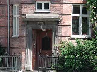

From:
Date: 7 Oct 2002 03:23:27
Message: <3da1366f$1@news.povray.org>
If I recollect right, these are real buildings? If it is so, the ignore this
remark, but otherwise I would like to note that the window above the left
door seems to be placed higher than the other windows which looks odd to me.
Date: 7 Oct 2002 05:07:24
Message: <Xns92A070E58F286raf256com@204.213.191.226>
> AA. My
try rendering simple checker plane scene, with camera observing the
horizont and with small checker scale. It is example of almost impossible
to get rid of alias.
In this case You can use:
threshold 0.00001 method 2 depth 5..7
or typical AA, but render scene at x5 higher resolution and then down-
sample, but it would in fact be same as threshold 0.00001
From: Marc Jacquier
Date: 7 Oct 2002 05:40:17
Message: <3da15681@news.povray.org>
Xns### [at] 204213191226...
I usually blow image at twice resolution and shrink it back both with
interpolation
Marc
From: Ib Rasmussen
Date: 7 Oct 2002 11:27:16
Message: <3DA1A7CC.1090809@ibras.dk>
They are real buildings (if I had designed them myself, there would be
much more standardization, and not eg 26 different windows), so if you
are unhappy with the design, you have to take it up with the architect.
   As the building is from 1904, he may be difficult to reach... :)
Photo attached to prove that it really looks like that.
/Ib
Download 'dscn7826.jpg' (25 KB)
Preview of image 'dscn7826.jpg'

From: Ib Rasmussen
Date: 7 Oct 2002 11:37:15
Message: <3DA1AA1E.60509@ibras.dk>
I don't think the threshold has much influence, it is method 2 depth 5
that is equal to rendering at 5x and reducing. If I understand it right,
threshold only determines whether two neighbouring pixels are different
enough to need antialiasing. Antialiasing pixels that are almost
identical can't do much difference in the image IMNSHO.
/Ib
