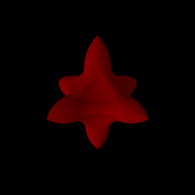

Marc Champagne posts in p.general a picture and a short scene of one
bogus blob for 3.5
I convert it to a scene of 3.1 and try it.
The bug was already there.
The good news is that the bug is due to the 'convex hull optimisation'
(whatever it can be) in the blob code.
The sad news is that I do not understand the math used for this bogus thing.
So, have a look and cry!!!!
Here the code for 3.1:

And two images: one from 3.1, and the same from patched code so as to
comment out the optimisation (as suggested during 3.5 beta, french
reader can get more information at
http://jgrimbert.free.fr/pov/correct/blobc.html
Have a nice day!
Download 'blob.png' (26 KB) Download 'blobg+.png' (26 KB)
Preview of image 'blob.png'
Preview of image 'blobg+.png'

Seems self-evident. Was there a significant render time change? I have to
ask that since the operative word mentioned was "optimisation".
I didn't get the same image output using v3.5 as shown on the web page you
gave and using the accompanying script.
Is this only the version directive used to get a 3.1 image here, or did you
put it through POV 3.1? Sorry, but I couldn't figure that out from what you
said.
Yes, due to the nearly mandatory "sturm" and to the increase of the
number of root-solving (before, when the ray it the bounding box, the
root solving could have been avoided thanks to a 'simple' if [but that
if is currently bogus).
Only the top two images were done with unmodified 3.1;
The four images at the bottom were done with the patch, that you do not
have, so of course, you cannot get the same picture.
If the two top images are also different with 3.5 (excepted for any
gamma correction), then some default values must have been updated from
3.1 to 3.5 (
or do I need to try them in 3.5 ? I'm a bit lazy right now :-)
> said.
I put it through 3.1
