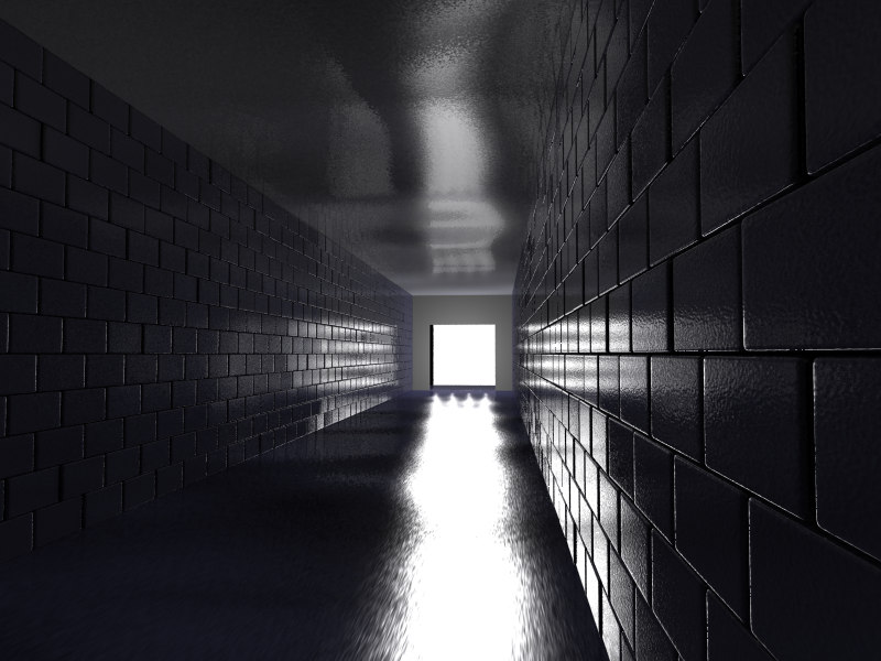

Hi,
hmm, i don't know what to say.... suggestions? comments :o)
Marcus
Download 'floor1.jpg' (78 KB)

Well, not much to nitpick...
The tiles look great, but otherwise there's not much to
comment on... Lighting looks fine, though the reflection
on the floor is a little too strong IMO.

I like this. An ominous looking figure casting a long shadow towards the viewer
would make this spooky looking.
FWIW: I've never seen a ceiling quite that shiny and another normal to simulate
floor tiles ( or actual floor tile objects) would help. Also this looks like
some kind of institutional building, so I might expect some sprinkler nozzles,
recessed light fixtures and maybe an exit sign or some such on the ceiling.
Let's see some more.

Hi,
> comment on...
Hmm.. yes, my first real try to do something better than spheres and
glass :o)
Yes, thats right... i've decreased it... looks a bit better, but i think
i have to make up a good texture for the floor...
bye, Marcus

Hi,
Yes, thats what i wanted to do, but i think my pov-skills aren't enough
to realize this... although i'll try to do so.
I did not understood this ... my english knowledge isn't the best ;) The
floor has to look like (in german i would say Lenolium - kann auch kein
deutsch....) if someone knows this in english ;o)
yes, tahts right, good idea with the sprinklers :)
i'm working on it!
bye, Marcus
linoleum (in corespondence to the german Linoleum :-)) Isn't it even a
Trademark?
Aren't those tiles a bit to big? Judging from the doorway they are about
20x20 cm, is this intended?
Marc-Hendrik

Great reflections on the wall tiles. As the others said - the floor
highlight looks too bright. I like the bumpiness of the ceiling a lot,
too - good attention to details. Some more details to the doorway, such
as an actual door, would make it more interesting.
/ Martin

Hi,
> Trademark?
Trademark? I don't know ... thanks :o)
It's intended... they are long 40cm and 20cm in height. very good
aproximation :)
bye, Marcus
thanks, in my newest version (still working :o)) the floor is less
reflective.. To the doorway and details; i'm currently working on it :)
bye

I don't like the way the lights are set up, on the reflections you can
easily see its a 4x4 grid of lights (or a 4x4 area light) Other than that I
really like the feel of it. Oh ceiling panals would be really cool too :)
maybe even some moldy ones!
