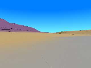

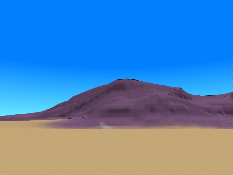

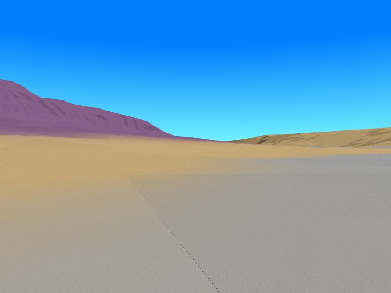

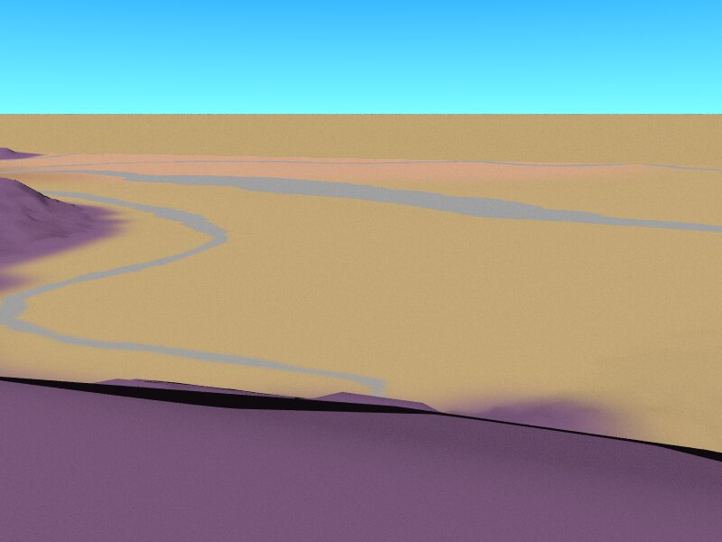

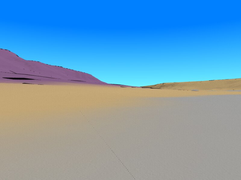

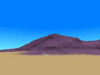

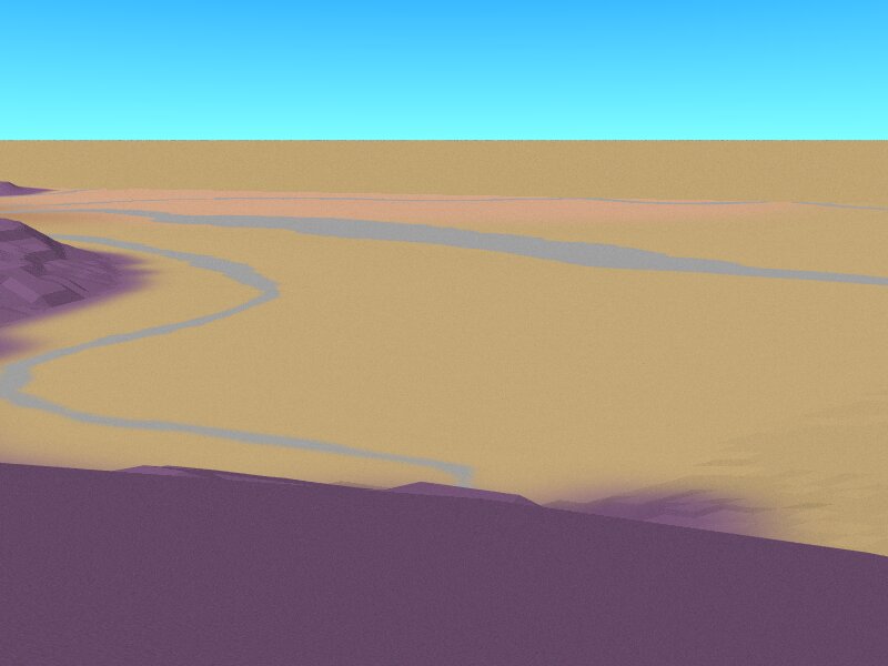

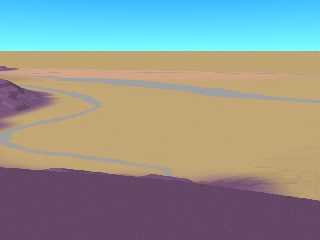

Hi tracers!

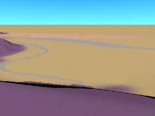

Finally, after 15 weeks of cumbersome 16bit HF pixeling (425,000 pixels
placed manually!), I got together the first small slice of southern
Kandahar province, covering an area of 10.795 by 25.4 kms.
Then after battling with a texture bitmap at a 10 times higher
resolution (4,250 by 10,000 pixels) which even under Linux brought my
system to the verge of crashing (while editing with the GIMP, I had to
use several layers), I started to render the first views of the scenery.
There is also the question whether smooth pigment/texture transition on
a HF can be done procedurally rather than with such huge bitmaps, but at
the moment, this is not the main problem.

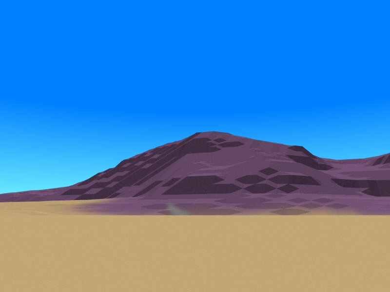

Instead, as you see in the images attached here, whenever I used
"smooth" with the HF, strange shadows appeared where no shadows should
be at all... without "smooth" they disappear (see images with a 'b' in
their filename).
Is there a way to avoid this - or is it just a bug with which I've to
learn to live?
See you in Khyberspace -
http://home.arcor.de/yadgar/khyberspace/index-e.html
Yadgar
Now playing: Give Love Each Day (Yes)
Download 'chakghar0018b.jpg' (29 KB) Download 'chakghar0016b.jpg' (28 KB) Download 'chakghar0017.jpg' (35 KB) Download 'chakghar0017b.jpg' (36 KB) Download 'chakghar0018.jpg' (26 KB) Download 'chakghar0016.jpg' (28 KB)
Preview of image 'chakghar0018b.jpg'
Preview of image 'chakghar0016b.jpg'
Preview of image 'chakghar0017.jpg'
Preview of image 'chakghar0017b.jpg'
Preview of image 'chakghar0018.jpg'
Preview of image 'chakghar0016.jpg'
From: Mick Hazelgrove
Subject: Re: Return to PoVghanistan - smooth HF bug in 3.5? (6 x JPG 800 x 600, 180 KB)
Date: 10 Aug 2002 11:56:01
Message: <3d553791@news.povray.org>
Hi Jorg
If you use a normal on the HF the dark shapes will generally dissapear.
Mick
From: Marc-Hendrik Bremer
Date: 10 Aug 2002 12:01:22
Message: <3d5538d2@news.povray.org>
news:3D553C59.7D7659C6@tiscalinet.de...
> their filename).
This seems to be the known bug with smooth heightfields. Try
"double_illuminate" with the Hf, this should remove the black spots. If this
does not work, you may want to try to make an Isosurface out of your
image_map. This might be to slow (depends on the necessary max_gradient),
but IIRC there are no such problems wih isosurfaces. Interpolate the
image_map by "interpolate 4" (I think method 2 does not work well in this
context). This should remove those black-spot-artefactlines, too.
In it's current state, your afganistan does not look at all as pre-war, to
the opposite it looks like same nukeular-war :-) BTW, are you sure you got
the scale right? I can't imagine any reasonabele scaled buildings and people
in conjunction with those hills/mountains.
I hope, you'll achieve what you are trying!
Marc-Hendrik
From: Jörg 'Yadgar' Bleimann
Date: 10 Aug 2002 13:53:39
Message: <3D5561E0.F372B6EA@tiscalinet.de>
High!

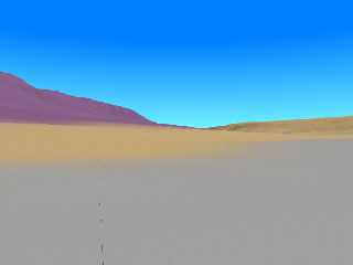

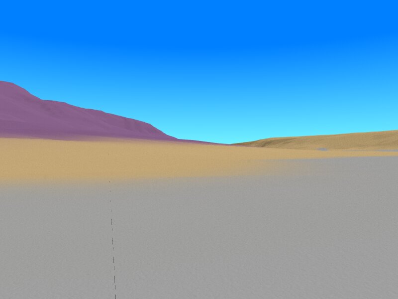

This worked perfectly, but there is still something unfixed - in the foreground
of the attached image, the light grey surface of the dry river bed looks
perforated!
Yes, it's somewhat macabre, but also my earlier attempts at graphical
Khyberspace (back in 1999 with Terragen) looked like thermonuclearly fried...
The scale is 1 unit = 1 metre; the large purplish hill (left on the attached
image) for example rises about 350 metres above the surrounding plains (and
1,430 metres above sea level).
Of course I want to construct traditional Afghan adobe villages with their
typical qalas (rectangular mud fortresses), irrigated fields, karezes
(subterranean irrigation channels), then also paths lined with trees (e. g.
poplars - popolus afghanica), the steppe and semi-desert plains with dry grass
and thorny shrubs... but firstly, I'm quite uneasy about placing all those
objects correctly on the heightfield, regarding their position in the y
direction. I looked up the trace function, it seems somewhat cryptic to me...
And more theoretical, there is so much to read before on Afghan village layouts,
house types, irrigation systems, vegetation... and much much later, I also want
to model the human and animal inhabitants of the villages! Possibly even this
ridiculously small strip of land will occupy me for the rest of my life...
Before finishing for today, one last practical question: how do I get the
typical irregular structure of adobe walls? Of course I could use some turbulent
normal (which pattern?), but I unfortunately suffer from the ambition to do
everything as accurate as possible, so you might suggest using an isosurface...
See you in Khyberspace - http://home.arcor.de/yadgar/khyberspace/index-e.html
Afghanistan Chronicle: http://home.arcor.de/yadgar/
Yadgar, crying out for an Athlon 1800+ with at least 2 gigs of RAM... ;-)))
Now playing: Beyond and Before (Yes)
Now encoding: Pierrot - Maui Morning (Chaitanya Hari Deuter)
Download 'chakghar0016c.jpg' (26 KB)
Preview of image 'chakghar0016c.jpg'
In fact I used a HF!
See you in Khyberspace!
Yadgar
Date: 10 Aug 2002 14:14:25
Message: <3d555801@news.povray.org>
news:3D5561E0.F372B6EA@tiscalinet.de...
> High!
foreground
> perforated!
I noticed that, too. *Maybee* try to shift your look_at point just al little
bit, if look_at and the position of the camera are in a strait line, there
are some odd artefacts IIRC.
attached
(and
Oh, okay.
turbulent
do
isosurface...
Hm, I don't know for sure, what an adobe wall looks like (my dictionary
translates adobe with "Luftziegel"). Perhaps have al look at the
Irregular_Bricks_Ptrn in textures.inc. It's probably a good idea to choose
the used object (and method - normal or isosurf) by calculating the distance
to the camera. The mentiones pattern f.e. will work quite well as normal or
as function in an isosurface, that makes it easy to switch between both
methods.
If the walls are roughcasted the granite pattern will do quite a good job
IMHO.
I got an Athlon 1800+ recently (much less RAM though) and I can tell you,
that scenes still tend to render slowly.
CU,
Marc-Hendrik
From: Rafal 'Raf256' Maj
Date: 10 Aug 2002 14:17:22
Message: <Xns9266CDCA4FFD5raf256com@204.213.191.226>
news:3D5562CF.45779D12@tiscalinet.de
I ques he ment - use a
normal { bozo 0.001 scale 10 }
block in HF :)
No, the camera viewing direction isn't parallel to any axis, it faces
south-southwest and slightly upward!
