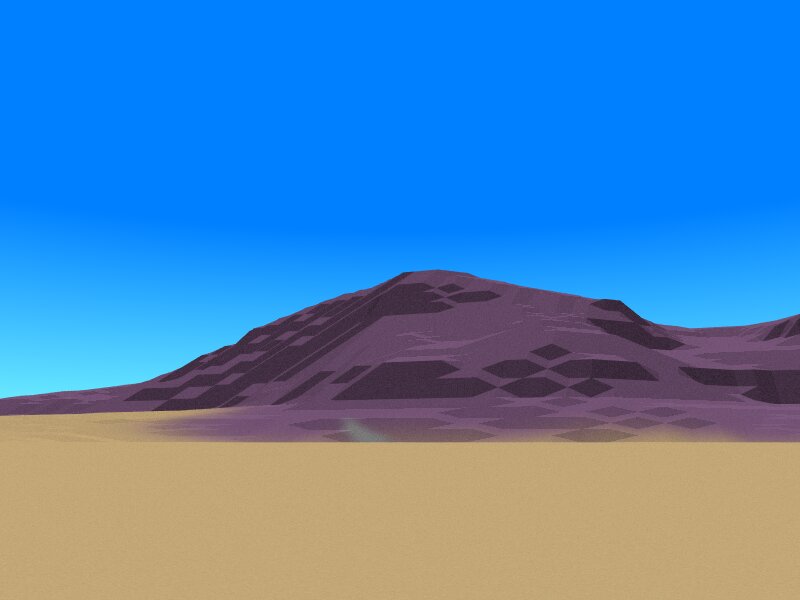

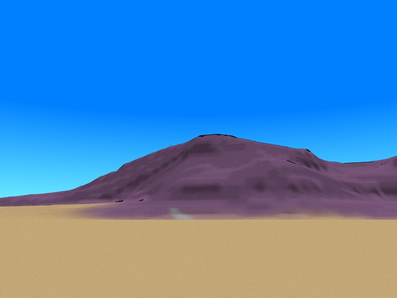

Hi tracers!
Finally, after 15 weeks of cumbersome 16bit HF pixeling (425,000 pixels
placed manually!), I got together the first small slice of southern
Kandahar province, covering an area of 10.795 by 25.4 kms.
Then after battling with a texture bitmap at a 10 times higher
resolution (4,250 by 10,000 pixels) which even under Linux brought my
system to the verge of crashing (while editing with the GIMP, I had to
use several layers), I started to render the first views of the scenery.
There is also the question whether smooth pigment/texture transition on
a HF can be done procedurally rather than with such huge bitmaps, but at
the moment, this is not the main problem.

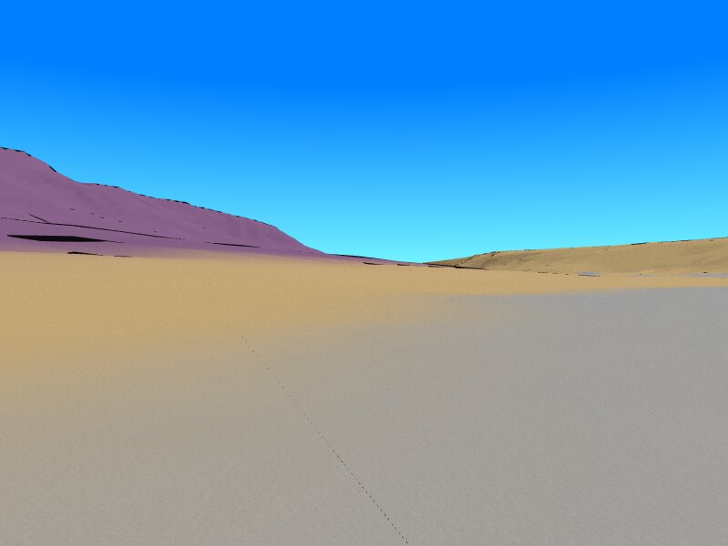

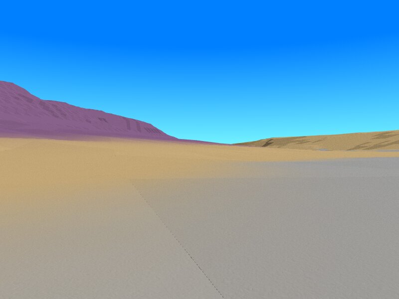

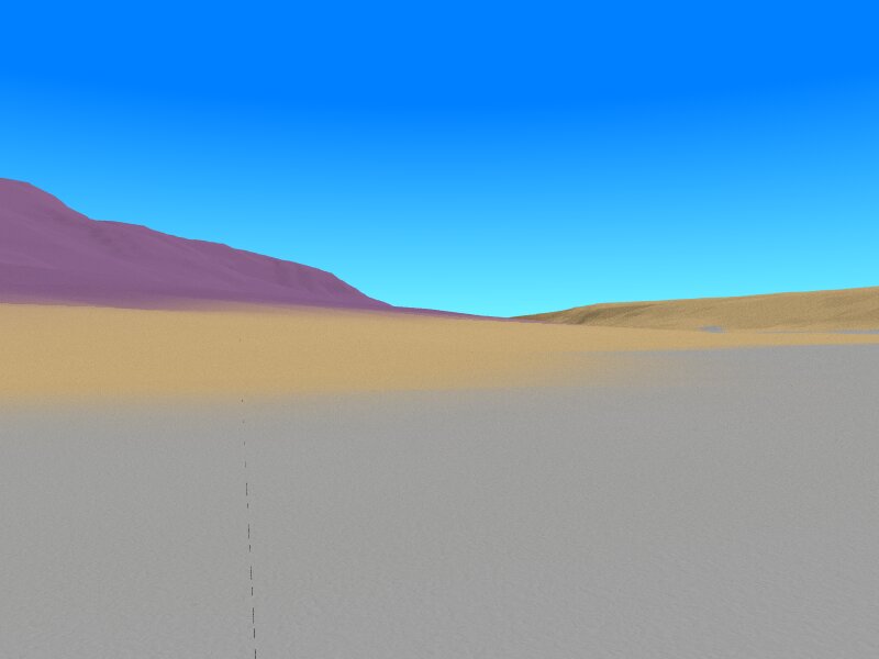

Instead, as you see in the images attached here, whenever I used
"smooth" with the HF, strange shadows appeared where no shadows should
be at all... without "smooth" they disappear (see images with a 'b' in
their filename).
Is there a way to avoid this - or is it just a bug with which I've to
learn to live?

From: Mick Hazelgrove
Subject: Re: Return to PoVghanistan - smooth HF bug in 3.5? (6 x JPG 800 x 600, 180 KB)
Date: 10 Aug 2002 11:56:01
Message: <3d553791@news.povray.org>
Hi Jorg
If you use a normal on the HF the dark shapes will generally dissapear.
Mick
From: Marc-Hendrik Bremer
Date: 10 Aug 2002 12:01:22
Message: <3d5538d2@news.povray.org>
news:3D553C59.7D7659C6@tiscalinet.de...
> their filename).
This seems to be the known bug with smooth heightfields. Try
"double_illuminate" with the Hf, this should remove the black spots. If this
does not work, you may want to try to make an Isosurface out of your
image_map. This might be to slow (depends on the necessary max_gradient),
but IIRC there are no such problems wih isosurfaces. Interpolate the
image_map by "interpolate 4" (I think method 2 does not work well in this
context). This should remove those black-spot-artefactlines, too.

From: Jörg 'Yadgar' Bleimann
Date: 10 Aug 2002 13:53:39
Message: <3D5561E0.F372B6EA@tiscalinet.de>
High!
This worked perfectly, but there is still something unfixed - in the foreground
of the attached image, the light grey surface of the dry river bed looks
perforated!

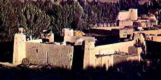

Of course I want to construct traditional Afghan adobe villages with their
typical qalas (rectangular mud fortresses), irrigated fields, karezes
(subterranean irrigation channels), then also paths lined with trees (e. g.
poplars - popolus afghanica), the steppe and semi-desert plains with dry grass
and thorny shrubs... but firstly, I'm quite uneasy about placing all those
objects correctly on the heightfield, regarding their position in the y

Before finishing for today, one last practical question: how do I get the
typical irregular structure of adobe walls? Of course I could use some turbulent
normal (which pattern?), but I unfortunately suffer from the ambition to do
everything as accurate as possible, so you might suggest using an isosurface...
See you in Khyberspace - http://home.arcor.de/yadgar/khyberspace/index-e.html
foreground
> perforated!
I noticed that, too. *Maybee* try to shift your look_at point just al little
bit, if look_at and the position of the camera are in a strait line, there
are some odd artefacts IIRC.
turbulent
do
isosurface...
Hm, I don't know for sure, what an adobe wall looks like (my dictionary
translates adobe with "Luftziegel"). Perhaps have al look at the
Irregular_Bricks_Ptrn in textures.inc. It's probably a good idea to choose
the used object (and method - normal or isosurf) by calculating the distance
to the camera. The mentiones pattern f.e. will work quite well as normal or
as function in an isosurface, that makes it easy to switch between both
methods.
If the walls are roughcasted the granite pattern will do quite a good job
IMHO.
Yes, "luftgetrocknete Lehmziegel" (sun-dried mud bricks)...
  methods.
I've tried this, but it looked very different from my notions of Afghan mud
walls - they are partly made of bricks, but
somehow the bricks are almost undiscernable, perhaps bricks and mortar look very
similar, or there is a kind of rough plaster
over them. Another type of mud wall is just formed amorphous mud, no bricks at
all.
  IMHO.
Subject: Examples of Afghan mud architecture (was: Re: Return to PoVghanistan )
Date: 12 Aug 2002 09:50:11
Message: <3D57CB11.763ACB59@tiscalinet.de>
High!
> If you have some reference photos, I could probably build some basic example
> of an isosurface based building ...
Here they are!
Afghanistan Chronicle: http://home.arcor.de/yadgar/index-e.htm
Yadgar
Download 'qal'a, bamiyan valley.jpg' (71 KB) Download 'blick auf =?iso-8859-1?q?an=e2rdarra=2ejpg?=.jpg' (235 KB) Download '=?iso-8859-1?q?lehmh=e4user?= in qal'a-ye saidan, provinz laghman.jpg' (146 KB)
Preview of image 'qal'a, bamiyan valley.jpg'
Preview of image 'blick auf =?iso-8859-1?q?an=e2rdarra=2ejpg?=.jpg'
Preview of image '=?iso-8859-1?q?lehmh=e4user?= in qal'a-ye saidan, provinz laghman.jpg'
