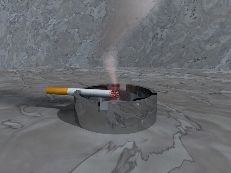

Hi all
This is one of my first attempts to make a kind of cigarette smoke.
It is a 800x600 with AA 0.3 render, with radiosity and 4 (I'll explain)
light sources (the 'sun' is an area_light). It took 4 hours on my XP
2000+ to render.
The smoke itself is a cone filled with a media whose density is a
function of my own. I had lots of pbs with the function, because if I
want a shape that matches most a real cigarette smoke's one, the
function must be very complex, and the render time reachs the sky. And
because of the color too. It seems that if I want blue reflects in the
scattering media, I need to set up his color to something like <1, 1,
0.5>. I understand it for absorption, but what about defuse light in
scattering media ? Am I forgetting someting ? Finally I choose a
scattering media with a very little extinction, and some emission and
absorption.
Not much to say about the ashtray and the cigarette (and no words about
the ugly environment :pp). The cigarette is just two cylinders with
color_maps. The red glowing part (sorry for my bad english) is two mixed
isosurfaces, one filled with a grey pigment, and the other with a red
emitting media. There are three red fading lights around the glowing
part, to make a red glow on the ashtray and on the smoke. This surely
needs to be improved, because of what happens on render time :(
Any comments, suggestions, questions ? Does anyone know how to make
realistic cigarette smoke ?
Jul### [at] cnedraorg
http://www.cnedra.org
Download 'clope-07.jpg' (119 KB)
Preview of image 'clope-07.jpg'

The render time isn't bad, but the smoke is.  I seem to remember a scene
that comes with POV called smoke.pov which had realy good smoke in it, but
I don't know if this was bundled with POV-Ray 3.5.
Your modelling is excelent, particularly the glowing cigarette ash.
But at the end of the day it's best to pack in while you can, I stopped
smoking over a month ago, and I'd recomend it to anyone.

The red glowing part is too red and dull.  It looks like the end of the
cigarette was dipped in blood.  Perhaps a little more orange and much
brighter?
Skip

Hello Julien. That's a very good cigarette (if ever there was such a
thing ;). I was thinking a week ago about maybe trying to use an
extruded patch and then placing a semi-transparent pigment onto it using
uv_mapping. This way, it might be possible to create the swirls smoke
has when it is in a room with little wind.

Tony Vigil wrote:
> smokegen.inc
I found it on the web, but it doesn't seem to work with pov 3.5 anymore.
Anyway, as far as I can see, it fakes smoke with little spheres filled
with a kind of bozo media. Does it really look like smoke ?
I'll look at it.
It uses 'halo' and I don't know yet how to replace it. I'll look for it.
Thank you.
I'm not modeling a cigarette because I like to smoke. Some things are
beautiful, I think (like cigarette smoke), and I don't see why I
couldn't render them :)

Samuel Benge wrote:
> Hello Julien.
Hi samuel
> thing ;).
Thanks. I like the way cigarette smoke go up in the air. Never said
cigarettes were good :-)
Hum, I don't like much uv mapping. I'm sure I can find some procedural
texture to simulate it. I'm still searching.

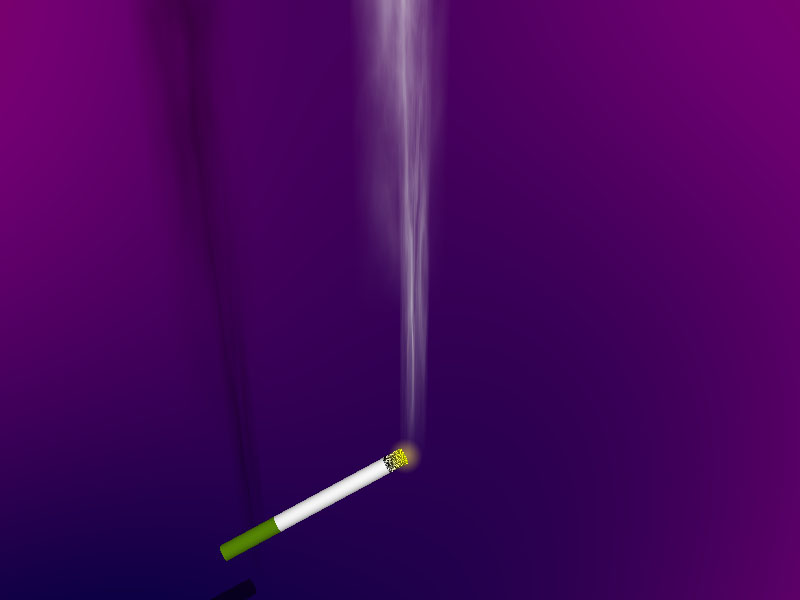

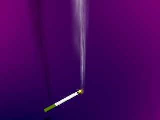

From: Tony Vigil
Subject: Re: [WIP] cigarette smoke (120ko)
Date: 30 Jul 2002 14:32:23
Message: <3d46dbb7@news.povray.org>
How's this look?  Just the smoke - not the cig.
Download 'smoketest.jpg' (21 KB)
