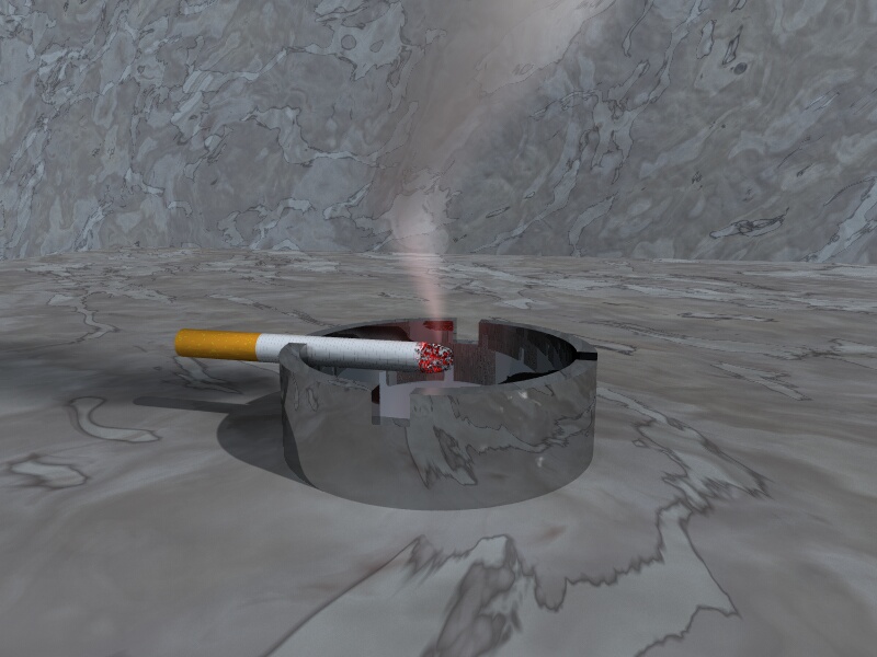

Hi all
This is one of my first attempts to make a kind of cigarette smoke.
It is a 800x600 with AA 0.3 render, with radiosity and 4 (I'll explain)
light sources (the 'sun' is an area_light). It took 4 hours on my XP
2000+ to render.
The smoke itself is a cone filled with a media whose density is a
function of my own. I had lots of pbs with the function, because if I
want a shape that matches most a real cigarette smoke's one, the
function must be very complex, and the render time reachs the sky. And
because of the color too. It seems that if I want blue reflects in the
scattering media, I need to set up his color to something like <1, 1,
0.5>. I understand it for absorption, but what about defuse light in
scattering media ? Am I forgetting someting ? Finally I choose a
scattering media with a very little extinction, and some emission and
absorption.
Not much to say about the ashtray and the cigarette (and no words about
the ugly environment :pp). The cigarette is just two cylinders with
color_maps. The red glowing part (sorry for my bad english) is two mixed
isosurfaces, one filled with a grey pigment, and the other with a red
emitting media. There are three red fading lights around the glowing
part, to make a red glow on the ashtray and on the smoke. This surely
needs to be improved, because of what happens on render time :(
Any comments, suggestions, questions ? Does anyone know how to make
realistic cigarette smoke ?
Jul### [at] cnedraorg
http://www.cnedra.org
Download 'clope-07.jpg' (119 KB)
Preview of image 'clope-07.jpg'

From: Skip Talbot
Subject: Re: [WIP] cigarette smoke (120ko)
Date: 29 Jul 2002 20:21:10
Message: <3d45dbf6@news.povray.org>
The red glowing part is too red and dull.  It looks like the end of the
cigarette was dipped in blood.  Perhaps a little more orange and much
brighter?
Skip

From: Julien Gourdon
Date: 30 Jul 2002 12:39:31
Message: <3D46C175.2070301@cnedra.org>
Steve wrote:
> The render time isn't bad, but the smoke is.  I seem to remember a scene
> that comes with POV called smoke.pov which had realy good smoke in it, but
> I don't know if this was bundled with POV-Ray 3.5.
It uses 'halo' and I don't know yet how to replace it. I'll look for it.
> Your modelling is excelent, particularly the glowing cigarette ash.
Thank you.
> But at the end of the day it's best to pack in while you can, I stopped
> smoking over a month ago, and I'd recomend it to anyone.
I'm not modeling a cigarette because I like to smoke. Some things are
beautiful, I think (like cigarette smoke), and I don't see why I
couldn't render them :)

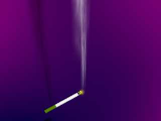

From: Tony Vigil
Date: 30 Jul 2002 14:32:23
Message: <3d46dbb7@news.povray.org>
How's this look?  Just the smoke - not the cig.
Download 'smoketest.jpg' (21 KB)
