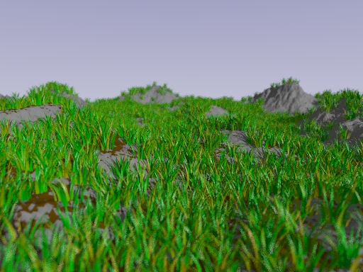

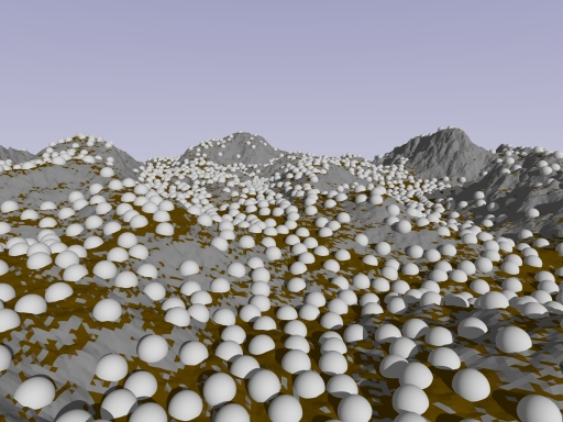

Hi all!
After a long time of having produced nothing worthwhile to be shown,
I've spent the last few days to sort and implement a set of macros I've
had spinning in my head and experimenting with for a few weeks now.
First a few words to the images: Both use the same heightfields, and
both use the same positions for the grass-patches / spheres. The actual
effect created with the macros is found in the detail:
1. Objects don't intersect (based on radius, not actual object, so
grass-blades
may still intersect)
2. Placement is calculated by checking slope and irregularities of the
nearby vicinity (to avoid placing objects on a tip of an otherwise
unusable field)
The grass-patches are created with some specially written macros,
that make usage of the mesh-modelling-macros I've scripted for
my "Gerberas" image, and are no new invention, just a revisit of a WIP.
What's the purpose of this?
For one, grass never grows in single blades (at least not naturally), so
I
needed to create patches that I would place on a heightfield.
Then, these patches shouldn't overlap too much, which is why the
vegetation-algorithm avoids intersections.
And the slope should be taken into account, as well plateau-checking
(objects
won't be placed where some part would be hanging above a chasm).
Questions, comments, suggestions, criticism, all is welcome.
Please note though that the images are mere tests of the algorithms, and
are only designed to visually please on a secondary basis.
Tim Nikias
Email: Tim### [at] gmxde
Download 'veg_sph.jpg' (126 KB) Download 'veg_grs.jpg' (141 KB)
Preview of image 'veg_sph.jpg'
Preview of image 'veg_grs.jpg'

How many spheres are there and how long did it take to place them all? Are you
using a blockmap?
I like the grass colour, and the effect in the high density regions is good. The
heightfield distorts my perspective somewhat though, because what looks like a
mountain in the background must actually be a small mound (considering the scale
of the grass).
MJL

> Looks promising.
Thank you, that's what I thought too! ;-)
> using a blockmap?
I think there were something around 2600-something spheres, but I
didn't take track of how long it took to generate the places. Not too
long though, a few minutes (under ten). It tried 150 times to add another
50 to the existing ones. While processing, a grid is used (blockmap?), in
which the positions are stored, in order to check only nearby grids for
collisions, not the entire amount of exisiting objects, but in the end,
all positions are saved into a single file, which is then read to place the
spheres/grass-patches (for that I still need to write a macro).
> of the grass).
Thanks, the grass was actually just taken from a similiar image (without
the vegetation algorithm) a few months ago, nothing too funky. Every grass-blade
gets a texture picked from a User-Defined array. Though the amount of
textures are hard-coded (once generated, a blade would always use index
5, for example), I can easily use the grass-patches and some different textures
to vegetate a different climate. Makes it more versatile in use.
Thanks for the comments!
