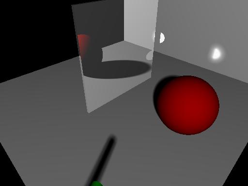

Actually I think it works as expected, see image.
The green cylinder is where the spot comes from. In it is a point light.
The overall light doesn't cast photons for speeds sake.

From:
Subject: Re: is there a way to make a laser
Date: 21 May 2002 15:40:54
Message: <3ceaa2c6$1@news.povray.org>
A cylindrical light source could be better for a laser.

Try that same image you just posted with a cylinder light source and no
actual cylinder object, and see if it still works. It might; I'm not sure.
Move the light real close to the photon reflecting object to see.
