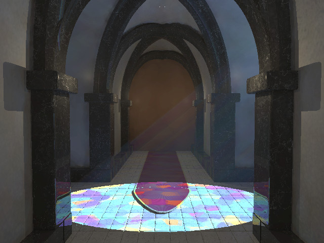

Just something I've been working on.. it seems like all my scenes get
abandoned halfway through, and all of them will eventually need a much
faster computer to do a decent final render. But I guess we all know
what that's like...
Haven't figured out what to do with the lighting yet. I might tone down
the stained glass light and let the candles (or lamps?) do more of the
lighting work (you can't see them, I know, but there's a point light on
each pillar). Or I might get rid of them and just light the scene with
the stained glass.. what do you think?
The brown thing in back is a mockup wooden door; I haven't made the real
thing yet.
Suggestions welcome; there are some objects I could add to the scene but
I'm somewhat at a loss here.
-Xplo

I think if you killed the pointlight on each pillar and brightened the sun
light, lighting the scene with radiosity, it would look better.
But, and I think this would improve the scene more than what I just
mentioned, it might look good if you moved the sun so that the light didn't
fall right on the center of the floor... make it hit the walls and create
interesting shapes.
That plus radiosity could look really neat.
- Slime
[ http://www.slimeland.com/ ]
[ http://www.slimeland.com/images/ ]

I agree on every points and I look forward seeing the result it'd be great
