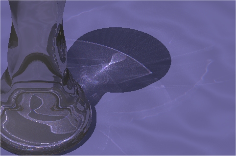

I've been working on my Gerbera-Image and tried
to use the dispersion of photons for a more realistic
look.
When tracing with a spacing of .0001 and using
a dispersion of 1.01, I get something around
40 million photons and the saved file is
over 750MB big.
Nontheless, the effect (though I've enlargened
the radius of a photon not by 5, as mentioned
in the docs, but by 7) is more or less useless.
It takes 2.5 hours to calculate the image, and the
result just isn't worth it.
Here's a close-up.
In case you're saying: "Well, THAT close..."
The image needs to be traced in extreme
sizes, so that I can print it with a very
good Laserprinter with incredible amount
of detail.
I'll be experimenting with three lightsources
(one for red, green and blue) and look if I
can get satisfying results that way.
Any comments, suggestions?
Tim Nikias
Email: Tim### [at] gmxde
Download 'dispersion.jpg' (80 KB)
Preview of image 'dispersion.jpg'

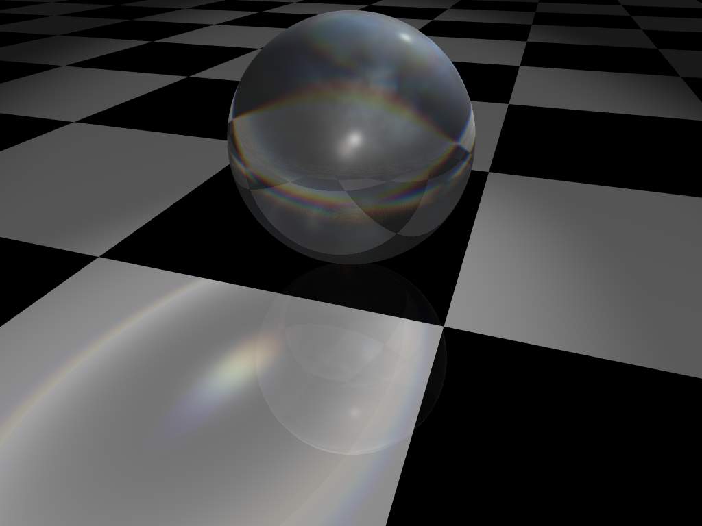

When Darren came out with the dispersion patch, it didn't do caustics
(and photons weren't around yet IIRC), so I tried to fake it with
light sources. The idea is to use quite a few light sources in line
colored like the spectrum and use caustics (or now photons). Not too
realistic but looks good at least.
The attached image is an example. The dispersion inside the orb comes
from Darren's patch, the dispersion in the faked caustics was made
with that trick.
It used to be a nice trick before dispersion + photons came out. I
don't know why they didn't work in your case, too low dispersion
maybe?
Peter Popov ICQ : 15002700

From: Tim Nikias
Subject: Re: Dispersion photons... No good...
Date: 21 Apr 2002 06:04:56
Message: <3C99BE52.AF1A5F2B@gmx.de>
Caustics don't give the same look as photons do,
for obvious reasons.
I think I'll just stick to white photons and
leave the photons out. It's also very
probable that you don't observe this
kind of dispersion very much, and then
this tiny detail may be not worth the
parsing time (2.5 hours and doesn't look
good = more time perhaps better?)
Thanks for sharing your experience!

From: Tim Nikias
Date: 21 Apr 2002 06:05:48
Message: <3C99BE86.B70BF1D2@gmx.de>
You mean jittering the photons? I haven't looked
yet, but is that actually possible? I'll be looking at
the docs.
RAY wrote:
> Yes, jitter.
> __________________
>  RAY
Tim Nikias

From: Peter Popov
Date: 21 Apr 2002 16:56:50
Message: <vm86cu870cff9ur1cs66kml36cuuctrtit@4ax.com>
On Thu, 21 Mar 2002 12:04:50 +0100, Tim Nikias <tim### [at] gmxde>
I never said they do. The trick should work with photons as well. I
don't know what causes your photons to malfunction (with a 400 MHz
K6/III I'm not the one to test dispersion photons...) but even so, the
trick I am offering should work. I lost the source long ago and
couldn't find in on this server but it shouldn't be too hard to do.
