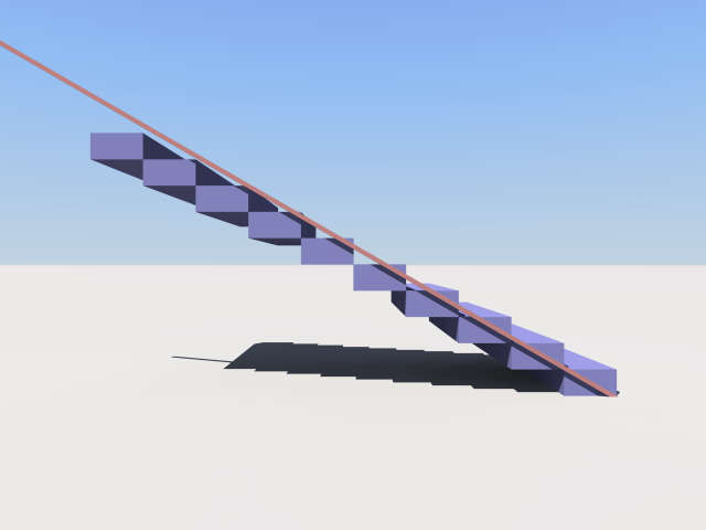

Okay, this is driving me nuts. I have a bunch of 4 x .5 x 1 boxes which
are stacked corner to corner in a stair pattern. Given their layout, I
thought/assumed that they make a 30 degree angle with the ground (a
plane), but when I added another box on the side and rotated it up 30
degrees, it didn't line up with the blocks!
I'm stumped. Barring some kind of bug, I can't imagine why I'm having
this problem; the math isn't particularly complicated here. Can anyone
help me with this? Code and example image follow:

From: Slime
Subject: Re: Stupid math error
Date: 1 Apr 2002 23:11:19
Message: <3ca92f67$1@news.povray.org>
The angle between the horizontal and the diagonal of a box with width 1 and
height .5 is
arctan(.5/1) = 26.56505117
The *sine* of 30 is 1/2. Not the tangent. If the *diagonal* had a length of
1, and the box had a height of .5, then the angle would be 30 degrees.
- Slime
[ http://www.slimeland.com/ ]
[ http://www.slimeland.com/images/ ]

Instead of .5 use the tangent of your desired angle (30) for your y value. Since, your
z value is equal to (1) this will work
(unless I just got a giant case of stupid going).
.5773503
Grim
From: GrimDude
Date: 1 Apr 2002 23:25:16
Message: <3ca932ac@news.povray.org>
Oops, you'll have to change your translation of the steps in the y-direction by that
same value times your stair_row_count, in order
for this to work out.
Grim
From: Xplo Eristotle
Date: 1 Apr 2002 23:32:22
Message: <3CA934B1.FC270467@unforgettable.com>
> height .5 is
Doh!! Stupid trig functions, I always get them mixed up.. could have
sworn it was sine I wanted.
Thanks a lot.
-Xplo

Perhaps because the tangent of 30 degrees is about 0.577350269, not 0.5 ?
