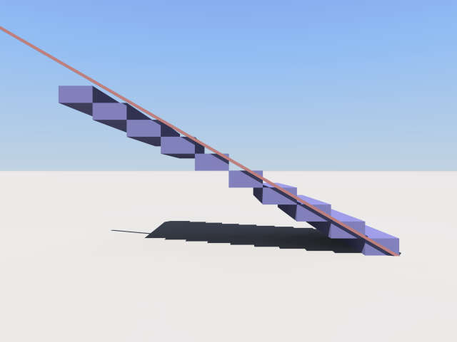

Okay, this is driving me nuts. I have a bunch of 4 x .5 x 1 boxes which
are stacked corner to corner in a stair pattern. Given their layout, I
thought/assumed that they make a 30 degree angle with the ground (a
plane), but when I added another box on the side and rotated it up 30
degrees, it didn't line up with the blocks!
I'm stumped. Barring some kind of bug, I can't imagine why I'm having
this problem; the math isn't particularly complicated here. Can anyone
help me with this? Code and example image follow:
#declare stair_row = union
	#declare stair_row_members = 1;
	#declare stair_row_count = 0;
	#while (stair_row_count < stair_row_members)
		box { <0, 0, 0> <4, .5, 1> }
		#declare stair_row_count = stair_row_count + 1;
	#end
#declare stair_block = union
	#declare stair_rows = 10;
	#while (stair_row_count < stair_rows)
		object { stair_row translate <0, stair_row_count/2, stair_row_count> }
	#end
#declare stair_rail = union
	box { <0, -in, 0> <in*1, 0, 15> rotate <-30, 0, 0> }
I'm using MacMegaPOV 0.7 (I don't care for the present interface of the
official beta) on Mac OS 8.6, if anyone cares.
-Xplo
Download 'mnah2-a.jpg' (13 KB)
Preview of image 'mnah2-a.jpg'

The angle between the horizontal and the diagonal of a box with width 1 and
height .5 is
arctan(.5/1) = 26.56505117
The *sine* of 30 is 1/2. Not the tangent. If the *diagonal* had a length of
1, and the box had a height of .5, then the angle would be 30 degrees.
- Slime

Instead of .5 use the tangent of your desired angle (30) for your y value. Since, your
z value is equal to (1) this will work
(unless I just got a giant case of stupid going).
.5773503
Grim

Oops, you'll have to change your translation of the steps in the y-direction by that
same value times your stair_row_count, in order
for this to work out.
Grim
> height .5 is
Doh!! Stupid trig functions, I always get them mixed up.. could have
sworn it was sine I wanted.
Thanks a lot.

Perhaps because the tangent of 30 degrees is about 0.577350269, not 0.5 ?
