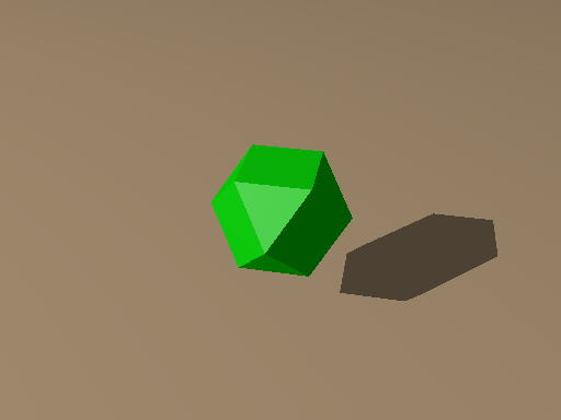

Hi all I need some help making some shapes,
I'm trying to kane an octahedron without taking a box and cutting off
edges, as I later want to make a regular dodecahedron and an icosahedron.
I finally found the prisim and it makes good stuff for other things but
i'm still new and cant find how to make the shapes above thanks for the
help!
this is what I have to do ?  but remember i'm new!

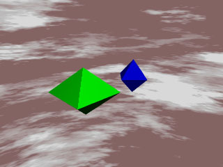

From: Flaming Monarch
Subject: Re: Help I need it
Date: 14 Mar 2002 18:50:05
Message: <3C91372C.2060503@gates.com>

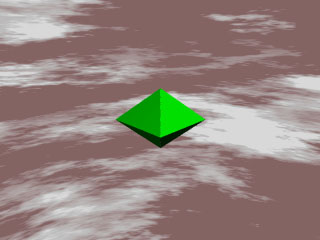

did the pic work It didnt on my end when I tried to use it so here it is
again
srry all
Flaming Monarch wrote:

I could see the first pic no problem.
I confess I have no idea how your box approach is working. The way I'd suggest
doing a regular octahedron is with plane intersections like this:

Cool I never thought of that way with the intersecting planes and stuff.
it worked and the code was tonnes shorter here is the way it loooked
the blue one is yours and the green mine

    Note that since the diagonal aspect is sqrt(2) you can take the 2's
above to 1.414 or so with the same results.  If you make it smaller than
that, it will trim the equator very nicely.  Now, two more rectangular
solids can trim the remaining 8 edges with no trouble at all.  Two solids,
one octahedron.  Four solids, one trimmed octahedron.
    For a perfectly symmetrical octahedron, scale the z axis to 1.414, for
obvious reasons.
Cheers!
Chip Shults
Subject: Re: Help I need it- okay, here it is
Date: 14 Mar 2002 23:51:45
Message: <3c917de1@news.povray.org>
Oh, yes- once you scale the octahedron at 1.414*y, since it is perfectly
symmetrical, you can then use one more cube and trim it into a perfect
cuboctahedron like this:
// start of POV code
#declare octahedron = intersection {
  object {box{<-2,-1,-1>, <2,1,1>} rotate 45*x}
  object {box{<-1,-1,-2>, <1,1,2>} rotate 45*z}
  pigment {color Green}
  finish {roughness .1 specular .1}
object {intersection {
  object {octahedron scale 1.414*y }
  object {box{-1, 1} rotate 45*y pigment {color Green} finish {roughness .1
specular .1} }
// end of POV code
  Note the attached image.
Cheers!
Chip Shults
Download 'Octahedr.jpg' (8 KB)
