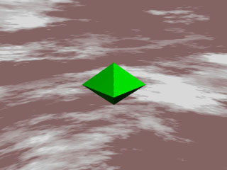

Hi all I need some help making some shapes,
I'm trying to kane an octahedron without taking a box and cutting off
edges, as I later want to make a regular dodecahedron and an icosahedron.
I finally found the prisim and it makes good stuff for other things but
i'm still new and cant find how to make the shapes above thanks for the
help!
this is what I have to do ?  but remember i'm new!
#declare cutter =
box {
<2.1,2.1,2.1>
<-2.1,-2.1,-2.1>
pigment {Green}
translate  <0,3.5,0>
difference {
box {
<2,2,2>
<-2,-2,-2>
pigment {Green}
object {cutter  rotate x*45}
object {cutter  rotate x*-45}
object {cutter  rotate x*45 scale -1}
object {cutter  rotate x*-45 scale -1}
object {cutter  rotate z*45}
object {cutter  rotate z*-45}
object {cutter  rotate z*45 scale -1}
object {cutter  rotate z*-45 scale -1}
Download 'shapes for conn.bmp.dat' (226 KB)

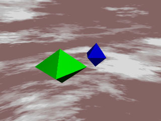

did the pic work It didnt on my end when I tried to use it so here it is

Cool I never thought of that way with the intersecting planes and stuff.
it worked and the code was tonnes shorter here is the way it loooked
the blue one is yours and the green mine

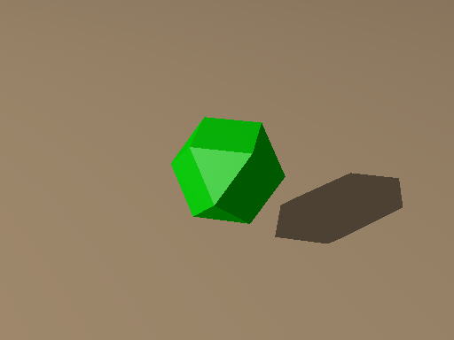

The simplest way to make an octahedron is the intersection of two
rectangular boxes.
object {intersection {
  object {box{<-2,-1,-1>, <2,1,1>} rotate 45*x}
  object {box{<-1,-1,-2>, <1,1,2>} rotate 45*z}
  pigment {color Green}
  finish {roughness .1 specular .1} }

Oh, yes- once you scale the octahedron at 1.414*y, since it is perfectly
symmetrical, you can then use one more cube and trim it into a perfect
cuboctahedron like this:
// start of POV code
#declare octahedron = intersection {
  object {octahedron scale 1.414*y }
  object {box{-1, 1} rotate 45*y pigment {color Green} finish {roughness .1
specular .1} }
// end of POV code
  Note the attached image.
Cheers!
Chip Shults
Download 'Octahedr.jpg' (8 KB)
