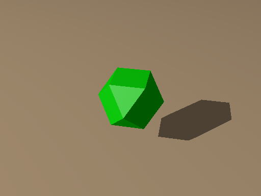

Hi all I need some help making some shapes,
I'm trying to kane an octahedron without taking a box and cutting off
edges, as I later want to make a regular dodecahedron and an icosahedron.
I finally found the prisim and it makes good stuff for other things but
i'm still new and cant find how to make the shapes above thanks for the
help!
this is what I have to do ?  but remember i'm new!
#declare cutter =
box {
<2.1,2.1,2.1>
<-2.1,-2.1,-2.1>
pigment {Green}
translate  <0,3.5,0>
difference {
box {
<2,2,2>
<-2,-2,-2>
pigment {Green}
object {cutter  rotate x*45}
object {cutter  rotate x*-45}
object {cutter  rotate x*45 scale -1}
object {cutter  rotate x*-45 scale -1}
object {cutter  rotate z*45}
object {cutter  rotate z*-45}
object {cutter  rotate z*45 scale -1}
object {cutter  rotate z*-45 scale -1}
Download 'shapes for conn.bmp.dat' (226 KB)

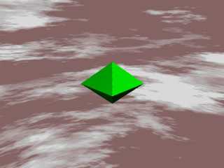

did the pic work It didnt on my end when I tried to use it so here it is
again
srry all

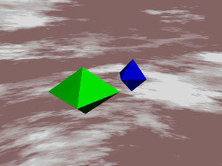

I could see the first pic no problem.
I confess I have no idea how your box approach is working. The way I'd suggest
doing a regular octahedron is with plane intersections like this:
intersection {
    plane { < 1, 1, 1>, 1 }
    plane { < 1, 1,-1>, 1 }
    plane { < 1,-1, 1>, 1 }
    plane { < 1,-1,-1>, 1 }
    plane { <-1, 1, 1>, 1 }
    plane { <-1, 1,-1>, 1 }
    plane { <-1,-1, 1>, 1 }
    plane { <-1,-1,-1>, 1 }
8 planes to describe an 8 sided solid :)
Hope this helps.

My box aproach was made by using the difference of the cutters and a
main box

Cool I never thought of that way with the intersecting planes and stuff.
it worked and the code was tonnes shorter here is the way it loooked
the blue one is yours and the green mine

Note that POV has no idea how to bound this, so it is completely
unbounded...POV will test against it for every ray traced. This isn't
much of a problem just for one, but if you use a large number of them
you should use an appropriate bounded_by statement.
You could also use an intersection of 2 or more boxes, which might be
faster and won't need manual bounding as badly...POV will be able to
come up with a bounding box, just not a perfect one.

The corners for the octahedron would be:
 Corner1 = <0,1,0>
Corner2 = <1,0,0>
Corner3 = <0,0,1>
Corner4 = <-1,0,0>
Corner5 = <0,0,-1>
Corner6 = <0,-1,0>
Just make triangles out of these. This will give you the fastest octahedron.
#mesh {
 triangle {Corner1, Corner2, Corner3}
 triangle {Corner1, Corner3, Corner4}
 triangle {Corner1, Corner4, Corner5}
 triangle {Corner1, Corner5, Corner2}
 triangle {Corner6, Corner2, Corner3}
 triangle {Corner6, Corner3, Corner4}
 triangle {Corner6, Corner4, Corner5}
 triangle {Corner6, Corner5, Corner2}
} /* end mesh */
 -Shay
 -Shay
"Flaming Monarch" <fla### [at] gatescom> wrote in message
news:3C9### [at] gatescom...
Subject: Re: Help I need it
Date: 14 Mar 2002 23:39:50
Message: <3c917b16$1@news.povray.org>
The simplest way to make an octahedron is the intersection of two
rectangular boxes.
object {intersection {
  object {box{<-2,-1,-1>, <2,1,1>} rotate 45*x}
  object {box{<-1,-1,-2>, <1,1,2>} rotate 45*z}
  pigment {color Green}
  finish {roughness .1 specular .1} }

Subject: Re: Help I need it- okay, here it is
Date: 14 Mar 2002 23:51:45
Message: <3c917de1@news.povray.org>
Oh, yes- once you scale the octahedron at 1.414*y, since it is perfectly
symmetrical, you can then use one more cube and trim it into a perfect
cuboctahedron like this:
// start of POV code
#declare octahedron = intersection {
  object {octahedron scale 1.414*y }
  object {box{-1, 1} rotate 45*y pigment {color Green} finish {roughness .1
specular .1} }
// end of POV code
  Note the attached image.
Cheers!
Chip Shults
Download 'Octahedr.jpg' (8 KB)
