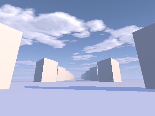

Here's the result of some experimenting with atmospheric perspective in
POV. I've found this phenomenon to be one of the key elements in
"natural" or "out door" CG scenes which are particularly striking.
Terragen does a particularly good job of it.
However,rendering atmospheric perspective with any degree of control in
POV, has always been a challange to me beyond the basic ground fog(with
its characteristic bright horizon) or blue scattering media.
Anyone have any particular solutions they'd like to share?
Abe
Download 'atm_perspec2.jpg' (16 KB)
Preview of image 'atm_perspec2.jpg'

First of all: What exactly did you do? Did you use fog, or
media to create that atmosphere effect?
If you'll take a look into my gallery, you'll find an image in the
widescreen section "featuring" a silver woman statuette with
a red heart in her hand.
If you look closely at the horizon, the clouds do "haze away".
I did it using several ground-fogs with different fog_alt
settings. The color was adjusted to fit the actual color of the
horizon, and using some transmit (or filter, depends) helps
a lot to take care of the radioactive horizon. When using several
ground-fogs and high transmit values, you can get certain colors,
objects fading into that color when very distant, and eliminate
the glowing horizon to some degree.
Tim Nikias
My methods are patented and top secret. But if you promise not to
tell...
The atmosphere is an additive combination of a blue scattering media and
a blueish absorption media. The goal was to produce a blue-ing of the
shadow elements in the scene and a reddening of the light elements as a
function of distance. Ultimately the red and blue would merge in a
neutral gray.

I appreciate the manner of control you exhibit in that scene, but
I couldn't get the particular effect of coloration on light and dark
areas I was after with fog.
Abe
> neutral gray.
Interesting approach. How long does it actually take? I mean,
you've got stacked-planes as clouds (I guess), so using just
media wouldn't be a clever idea (again, just another educated
guess), but probably a plane as container?
Like to elaborate a bit more on your code?
Tim Nikias
