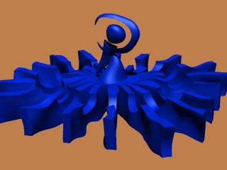

I made a first version of this include file in June 2001 but it was fairly
difficult to use since function names could not be passed as macro
parameters.
The file implements basic shapes and CSG operations as well as
transformations so all CSG objects using these shapes should be possible
to convert.
Currently available shape macros are:
- IC_Plane (Direction, Distance)
- IC_Sphere (Center, Radius)
- IC_Box (Start, End)
- IC_Torus (MaR, MiR)
- IC_Cylinder (Start, End, Radius)
- IC_Cone (Start, Radius1, End, Radius2)
Usage is still a bit ugly, but quite self explanatory, see the sample
scenes.
The first attached picture shows a sample CSG with a deformation using
noise functions.  It is all one isosurface object so it renders fairly
slow (nearly 2 hours on a K6).  Splitting things up into several objects
is probably a good idea.  I thought about implementing some kind of
bounding, but this would probably result in serious problems because of
infinite gradients.
The second sample refers to the recent discussion in p.g. about adding a
distance function to the povray shapes internally to allow proximity
calculations.
The include file and the sample scenes will be in p.b.s-f soon.

I think it would be very difficult to use this as a proximity pattern for
CSG shapes since the gradients of all the functions are different and
therefore the proximity is different for the single CSG elements.  Also
all differences are likely to produce artefacts (like on the upper left of
the central sphere here).
