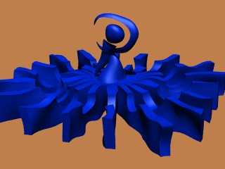

The first attached picture shows a sample CSG with a deformation using
noise functions.  It is all one isosurface object so it renders fairly
slow (nearly 2 hours on a K6).  Splitting things up into several objects
is probably a good idea.  I thought about implementing some kind of
bounding, but this would probably result in serious problems because of
infinite gradients.

I think it would be very difficult to use this as a proximity pattern for
CSG shapes since the gradients of all the functions are different and
therefore the proximity is different for the single CSG elements.  Also
all differences are likely to produce artefacts (like on the upper left of
the central sphere here).
