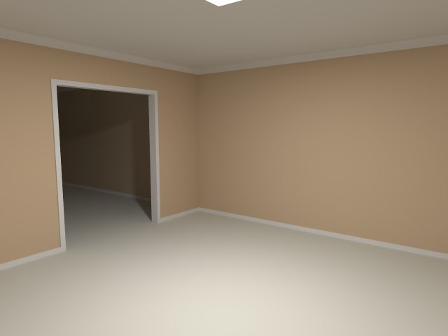

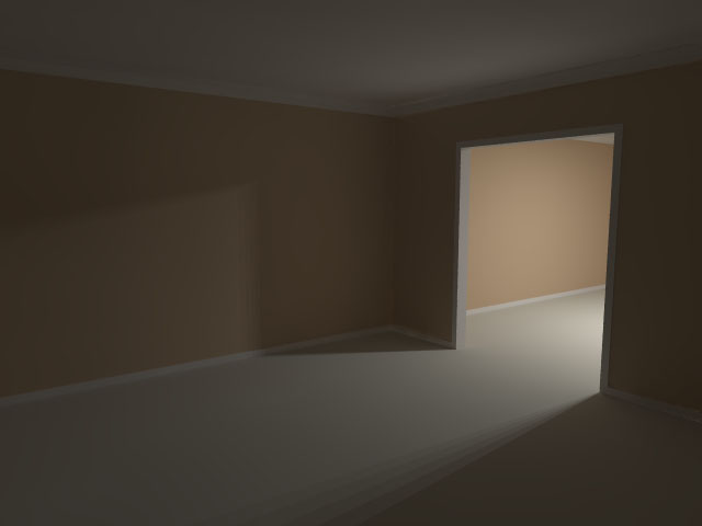

I saw Kari Kivisalo's suggestions to Tim Nikias on realistic light fading and
gave it a quick go. I set up two identical rooms and a doorway. In one room, a
light was placed slightly lower than the ceiling, but higher than the doorway
height. This light was square and used 25 spotlights are per Kari's suggestions.
I used radiostity with a recursion limit of 5 (probably a little excessive) and
here are the results.
    One is a shot from within the lit room. The other is the same shot, but from
within the unlit room. The imperfect soft shadows are caused by the set up of the
pseudo area-light. No post process was performed.
    I suggest we call these wonderful lights Kari-lights in honour of their
inventor :-)
MJL

From: JPGargoyle
Subject: Re: Rad with Kari-lights
Date: 22 Jan 2002 18:34:48
Message: <3c4df718$1@news.povray.org>
Great!
Pretty cool!
I like it a lot!
Best regards
Date: 22 Jan 2002 18:44:17
Message: <slrna4rtmh.c7s.steve@zero-pps.localdomain>
Lighting is great as you say, but the door way is far too wide.

From: Mark James Lewin
Date: 22 Jan 2002 19:11:06
Message: <3C4DFB40.EB832B3F@yahoo.com.au>
Date: 22 Jan 2002 19:13:17
Message: <3C4DFBC3.5C30F5C2@yahoo.com.au>
Thanks! Yes, the door is too wide, but you can't expect perfect geometry from a
10 minute "let's see how this turns out" sort of job.

From: Kari Kivisalo
Date: 22 Jan 2002 19:43:55
Message: <3C4E0781.1C9FDCA5@engineer.com>
For this one area_light D*x, D*z, 5, 5 jitter adaptive 0 would be
enough. I would say that if the nearest object is within 3*fade_distance
and more accurate lighting is needed then divide the source. Try it first
with one source and see what it looks like. cornell.pov in the beta
distribution can be used to see how dividing the source affects the lighting.
The N parameter divides the source to N^2 sub sources. N=3 was mainly
used to get better lighting on the front of the tall box, the rest
of the scene is ok with 1 source. Notice how the light intensity remains
constant even when the source is divided without altering source brightness.
It's because the light source color brightness is actually brightness/area
so when a source is divided to smaller sources they still have the same
area brightness.
> and here are the results.
Looks good and a fortunate coincidence is that the scene contrast
ratio matches nicely that of a typical monitor so no post processing
is needed :)
_____________
Kari Kivisalo
Date: 22 Jan 2002 20:30:51
Message: <3C4E0DEC.D2900806@yahoo.com.au>
> enough.
I seldom see the easy way first :-) I am still amazed at how much  indoor rad
scenes can benefit from these settings.
> is needed :)
Thank you.
If only POV had the ability to adjust colours before they are clipped and written
to file...
text{ttf"timrom.ttf"concat(#local O=1;#while(O<7)chr(val(substr(concat(#local Q=
1;#while(Q<7)str(asc(substr("???<?>",Q,1))-56,0,0),#local Q=Q+1;#end""),O,2))),#
local O=O+2;#end"").1,0pigment{rgb 9}translate-<1,.3,-2>} // MJL
