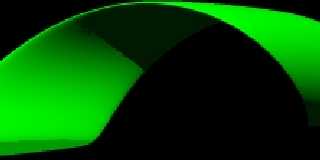

I was trying to figure out how to warp a cylinder into a sphere sweep
helix, but it didn't work.  It squished the thing for some reason.  My
thought was to turn the x dimension of the cylinder into the radius, and
the y dimension into the angle, but everything needs to be done
backwards.  I was trying to use a rectangular to polar conversion
formula, because of things needing to be backwards.
I would appreciate it if someone could tell how to do it right.  I would
also like to know how to do the same thing using parametic surfaces, and
what it was that I was doing wrong.
I think this is the code I was using.
#include "colors.inc"
#include "finish.inc"
light_source {<3,4,-5>*100 rgb 2}
camera {location <12,0,-14> look_at 0 }
#version unofficial MegaPov 0.7;
#declare Cyl= function{((x-3)^2+y^2)^.5 -1}
//plane{y,-2 pigment{White}}
#declare Cyl2 =  function {Cyl(x,z*cos(pi/3) - y*sin(pi/3),
  y*cos(pi/3) + z*sin(pi/3))}
#declare Cir = function{(x*cos(y)+x*sin(y))}
#declare Cir2 = function{Cyl2(sqr(x^2+y^2),atan2(x,y),z)}
isosurface{
   function {Cir2(x,y,z)}
    contained_by{box{-2*pi,2*pi}}
    method 2
    eval
    pigment{Green}
    finish{Shiny}

Subject: Re: Isofailure
Date: 17 Jan 2002 07:40:17
Message: <3C46C630.61EACAB8@gmx.de>
Why don't you use a built in helix function:
http://users.skynet.be/smellenbergh/buildin.html#Helix1
You can of course do it by hand, but this is a bit complicated, have a
look at the megapov source if you want to know.

From: Tor Olav Kristensen
Date: 17 Jan 2002 19:32:42
Message: <3C476CB6.B48C109E@hotmail.com>
I just had a very brief look at your code,
and right now I don't know if what you are
doing here are the right way to go.
(I'm not even sure if I understand what
shape you are trying make. Maybe I can
look at it tomorrow.)
BUT if you are doing conversion from
rectangular to polar coordinates, then
this expression looks suspicious:
Shouldn't sqr(x^2+y^2) be sqrt(x^2 + y^2) ?
And this function:
is equivalent to this function:
#declare Cir = function { x*(cos(y) + sin(y)) }
Was that your intention ?
Tor Olav
