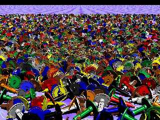

Hi Tracers!
After removing my additional 64 megs  module due to frequent crashes, I
tested the performance with the remaining 256 megs (on an AMD K6-II/380
MHz) by placing randomly 11, 000 of my plastic mouse wheels. Strangely,
there is a concentration of objects near the origin (camera location is
<0, 0.1, -0.4>, looking at <0, 0, 0>), though there are no quadratic
terms containing the random variable...
Rendering time: about 5:30 h, peak memory use: 309 megs
The next step would be a collision detector...
See you in Khyberspace -
http://www.geocities.com/electricafghan/index-e.html
Afghanistan Chronicle: http://www.ndh.net/home/bleimann/
Yadgar
Download 'mousewheel09.jpg' (293 KB)
Preview of image 'mousewheel09.jpg'

Yadgar wrote:
>Strangely,
If you're placing the wheels with the *orbit technique* (i.e. translate
x*radius*rand() rotate 360*rand()*y) you have to expect this, since every
radius is equally probable so the smaller the radius the smaller the circle
you put your objects on.
Jonathan.

From: Skip Talbot
Subject: Re: 11,000 Plastic Mouse Wheels (800 x 600, 293 KB)
Date: 8 Nov 2001 17:28:35
Message: <3beb0713$1@news.povray.org>
What is a good way to do collision testing?  Approximate the object with
an enclosing box?  And then how do you check it for intersections?
    Also, is there a formula or macro out there can fill and only fill a
perspective view?  Having objects outside the perspective projectors omitted
would optimize parse time.
Skip

From: Slime
Date: 8 Nov 2001 18:18:11
Message: <3beb12b3$1@news.povray.org>
If you're placing the objects in a way similar to this:
#declare r = rand(myseed)*maxradius;
#declare angle = rand(myseed)*360;
translate vrotate(x*r,angle*y);
then you'll have to change the "r" statement to this in order to remove the
concentration:
#declare r = rand(myseed)^.5*maxradius;
And that should spread it out evenly.
- Slime

From: Yadgar
Date: 9 Nov 2001 19:19:53
Message: <3BEC7965.BBB7E6E8@ndh.net>
JRG schrieb:
> Yadgar wrote:
> >Strangely,
> Jonathan.
No, my method is:
r=seed(3482) // seed values only examples!
a=seed(2321)
radius=rand(r)*2
ang=rand(a)*360
translate <radius*sin(ang*(pi/180)), 0, radius*cos(ang*(pi/180))>
From: Trevor Quayle
Date: 9 Nov 2001 21:29:07
Message: <3bec90f3@news.povray.org>
> No, my method is:
> a=seed(2321)
> radius=rand(r)*2
> ang=rand(a)*360
hmm... several points of interest here:
1) sin(ang*(pi/180)), i realize you are converting the angle to radians for
use in the sin() function, are you aware that the function radians(ang)
would do this?
2)why convert the angle and rad to coordinates instead of doing this:
translate x*radius
rotate y*ang
or if you want the object to maintain its original rotation:
rotate -y*ang
translate x*radius
rotate y*ang
3) as others have mentioned, and from the method you are using, you should
expect a large concentration in the centre, to spread out more evenly use:
 radius=sqrt(rand(r))*2
-tgq
