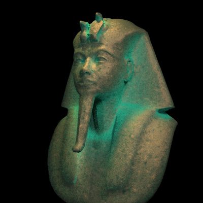

Based on the accessibility of a surface location. No height fields
were used :P

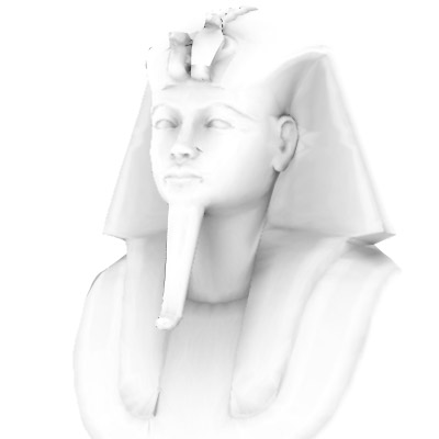

Couldn't tweak it any better so here it is. I rendered the "Arnold"
grime map from scene camera position using orthographic camera
and aligned in the scene to project from the camera position.
texture{
  image_pattern{sys "grime_map.bmp"}
  texture_map{
    [0.6 Grime]
    [1 Metal]
The problem with using radiosity to simulate accessibility
is that small surface variations on high visibility area get
outweighted by big low visibility areas. Some kind of local
equalization/high-pass operation would make it work better.
> were used :P
I think Chris Huff was planning some pattern for this working similar to
the visibility pattern i wrote but sampling in various directions.
