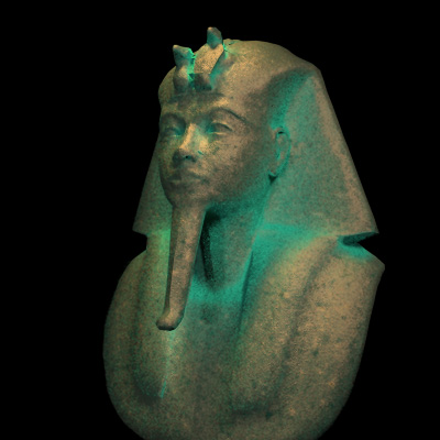

Based on the accessibility of a surface location. No height fields
were used :P

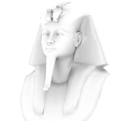

Couldn't tweak it any better so here it is. I rendered the "Arnold"
grime map from scene camera position using orthographic camera
and aligned in the scene to project from the camera position.
texture{
  image_pattern{sys "grime_map.bmp"}
  texture_map{
    [0.6 Grime]
    [1 Metal]
The problem with using radiosity to simulate accessibility
is that small surface variations on high visibility area get
outweighted by big low visibility areas. Some kind of local
equalization/high-pass operation would make it work better.
> were used :P
I think Chris Huff was planning some pattern for this working similar to
the visibility pattern i wrote but sampling in various directions.

ben paschke wrote:
> Concerning your latest patina experiments, may i suggest you have a look
> at an old test i did, but with the proximity pattern ..
> news://news.povray.org/3AA72A9B.7B8E4326%40rsp.com.au
The net effect of proximity pattern seems to be abs(curvature).
Proximity is about distance from surface and patina simulations
are based on visibility so it's natural one can't be used in place
of other. The reason it worked with a stack of balls is that the
highest curvature is where they intersect.
If proxomity pattern could select positive or negative curvature
it could be used to detect edges and apply wear and tear or deposit
grime on negative curvature areas.
Notice the concentration on both negative and positive high
curvature areas. http://www.pp.hv.fi/kkivisal/prox.jpg

From: ingo
Subject: Re: Patina/grime (40k)
Date: 31 Aug 2001 10:17:16
Message: <Xns910EA5B055A23seed7@povray.org>
in news:3B8F7FC3.D717E8FF@engineer.com Kari Kivisalo wrote:
> http://www.pp.htv.fi/kkivisal/prox.jpg
Interesting.
Just an idea I came up with while making a short bicycle tour this
afternoon. It may be complete nonsense.
 Shoot a ray at the object to be rendered. Put an imaginary sphere with
a given radius with its centre on the ray, its surface should toutch
the objects surface in the intersection point. Now check if the sphere
intersects somewhere with the object. If so, reduce the sphere radius
until it does not intersect anymore (the sphere should still be
toutching the object at the intersection point).
 Now make the grey-value of the objects pigment depends on the sphere's
radius.
 By setting limits to the sphere's sizes you could control the amount
of patina.
 Would something like this work? As a patch? As a clever combination of
macros and functions (3.5)?
Ingo
